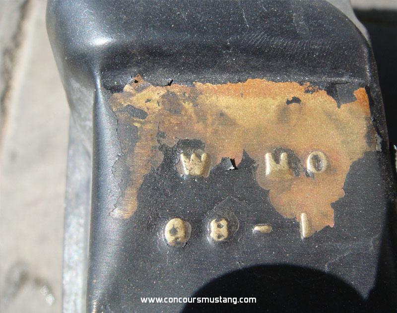

San Jose cars normally do not have an ID stamp on the side brackets.
They feature W MO on the top tank along with a date (on my 67 SJ car, anyhow).
They may also feature a tag soldered to the tank bracket on top with parts code.

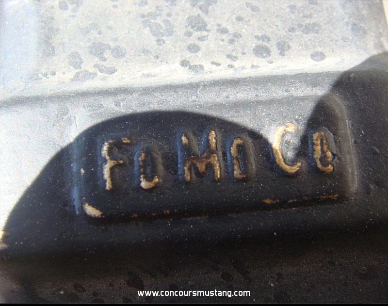

I have searched for a post that may help me ID my radiator or point me in the right direction to find the correct radiator for my car. I went to see my local radiator expert who advised me that I have an original OEM radiator, even though there are no markings on the tank or side mount brackets that I could find. I also asked about the automatic transmission lines and he said that Ford made the tanks that way and they used the same tanks for automatic's and standards and plugged the fittings on manual cars. I am sceptical that he has the right information so I am looking for a definitive confirmation here before I spend any money on this rad. It was working fine, but I had it dismantled based on the info I was given with the intension of rebuilding it. I have also been told that finding a correct 390 4 speed radiator is a tall order. I always just assumed that the top of the tank would have a FoMoCo stamp and that the side brackets would have a part number stamped on them.
Your radiator guy may still be good and a expert compared to most but he is lacking in some pertinent vintage Ford knowledge.  The early aftermarket tanks looked the same as the typical Ford version but did not have a Ford trademark. A factory radiator in your case should have a Ford trademark .  After market and also Ford service bottom tanks were typically of the automatic style and simply had plugs installed for a manual application. This one type fits all was so as to keep fewer types to stock. SJ radiators had a tag soldered on the top of the tank typically on the driver side. The Dearborn or Metuchen plants used radiators that had the engineering number metal stamped into the side strap.

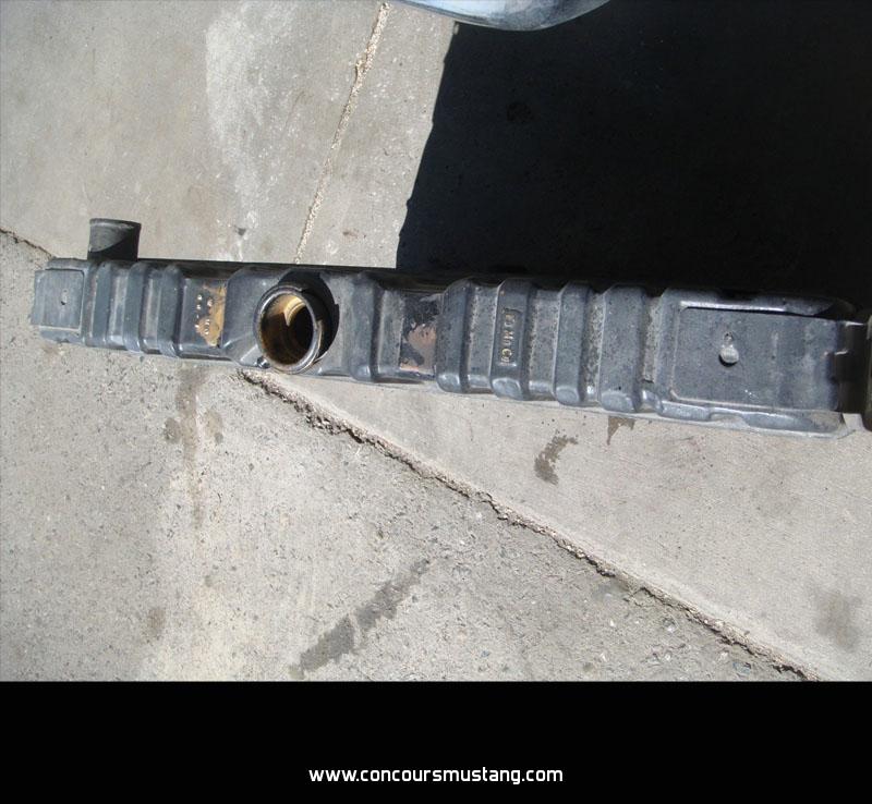

  • Posts: 24869
To focus more on the specific large big block style radiator for San Jose here are a few pictures of one example - without the soldered on ID tag :(
68-1 Date Jan 1968

Thanks Jeff that is great. I wonder how hard it would be to come by a correct tank. I have not been able to locate one as of yet. Would it be safe to assume that they are hard to find
Not Jeff but I would remind you so that you could widen your net that the 68 top tank is going to be the same for big block or small block (extra cooling radiator in the case of the small block).
Thanks Bob. That is great news. FYI I saw a post a few minutes ago for a small block rad for sale, but I cant find it now. It looked like a big block rad and had WMO stamped on it. I was hoping that it might be a rad I could use. I sent a PM so hopefully I hear back
