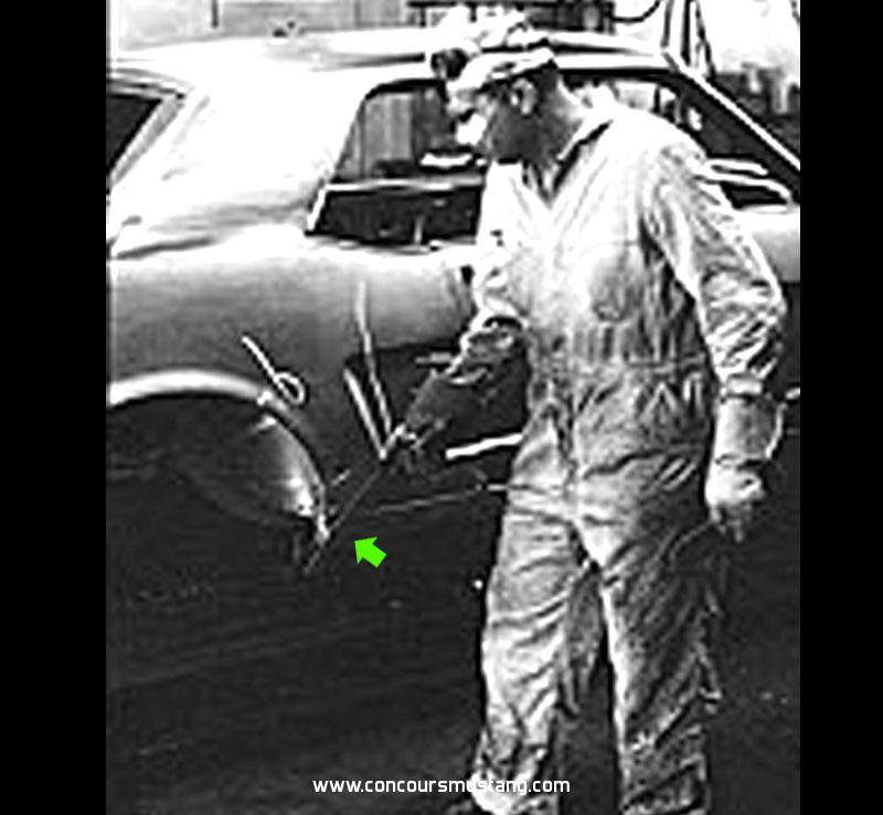

Only picture I could come up with is from a proof of a set of negatives from likely 65 Dearborn Assembly plant.  This worker looks like he is using a long wand with an angle head to spray in and up to apply the sound deadener to the rear wheel well. This is likely, IMHO the same worker and tool that he would have applied the sound deadener to the trunk quarter panel surfaces at the same station.
As anticipated he lacks much of what would be expected in the years that follow as far as personal protective equipment. Has a fixture that held a pad up covering his nose, a cap, some glasses (he's not using), gloves and coveralls

I wonder what kind of pumping action is used. Is under pressure like spray paint? I am guessing not because of all the splatter like trying to do it at home. I think it might be pressurized by a mechanical pump, much like a airless system. Less splatter and maybe easier to control because of a narrower pattern. Maybe?
Re: underbody/wheelwell sounddeadner
« Reply #6 on: March 31, 2019, 06:10:28 PM »
Believe you are correct. many other processes were hydraulically plumbed. Things like welding fixtures for one
