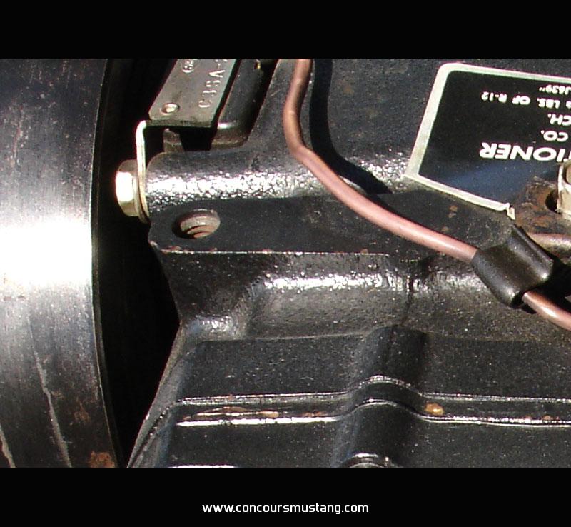

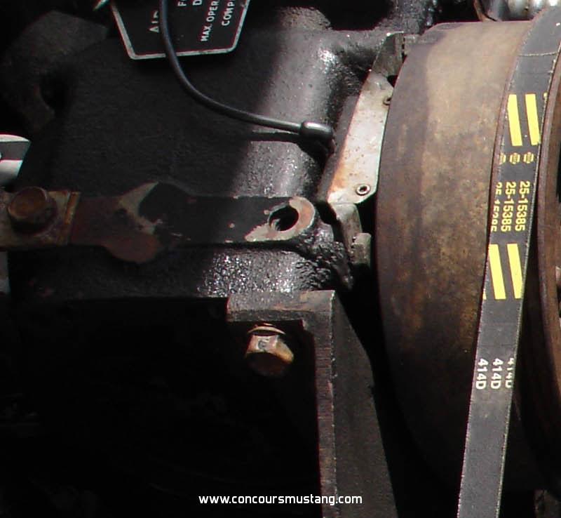

Here are a couple of pictures from unrestored cars that I hope help you identify the piece your looking for
Mid year 66 San Jose
Late year 66 San Jose
Have not had a need to purchase one in the past. I guess I would start with the usual  places. Ebay, parts dealers like Larson and wanted ads on sites like this one and as many others as you choose as you spread a wide net
