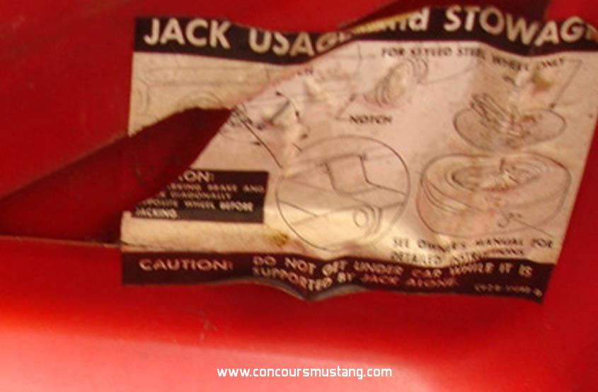

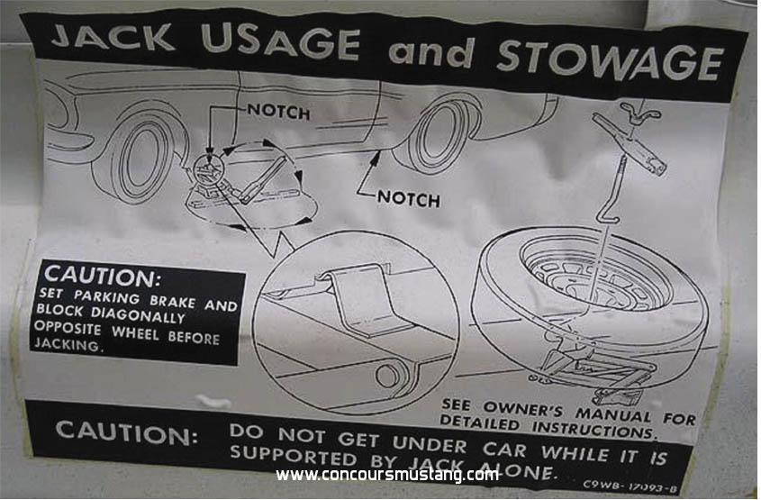

Is there a chance that when you flip the wheel and tire over your J hook will allow for jack to pass through and sit in the tire.   THere are multiple ways of jack mounting - per the various trunk lid stickers.   I THINK you need to flip over.

I believe the jack goes under the tire and flip the tire over (valve stem down). I place the J-bolt through the nearest lug bolt hole and the jack handle goes on top. Per 69 owner's manual.

Appears that it depends depends if you look at the jack/spare instructions. Still will not address the extreme angle of the J hook

Some examples . May not all be stored as original but does address angle of the rod. All look like they only have a small angle using the large center hole as indicated in the jacking instructions. Sure different sized aftermarket tires make allot of difference
up side down
