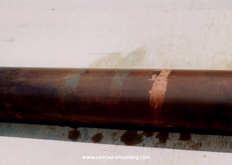

Identification stripes from front to rear for a 1970 Boss 302 from around the same time period are listed as - BUBULAV
Blue - Blue - Lavender
A picture of an original set below - of course colors are not as rich and deep as they were originally in the picture
For an extra - yokes (before they were welded to the tube) were painted orange
