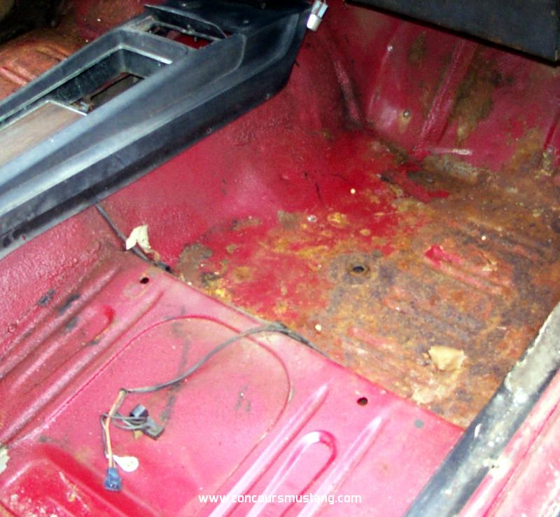

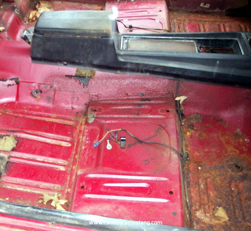

How was the seat release wiring routed to the seat?

There's a lower harness that plugs into the main convenience group harness behind the right kick panel. it runs across the floorpan and has plugs for the seat solenoids just under the outer seatback hinge. Each seat has a small harness at the outer seatback hinge that plugs into the solenoid in the seat back. If you have the "Electrical" assembly manual there's a page that shows everything ….
Hope this helps, John

Thanks , the wires have been poked through the vinal side of seat base.
I'll  look for wiring plans.

Hope these help. Looks like it runs from the passenger side kick panel - to the seat riser - then across
