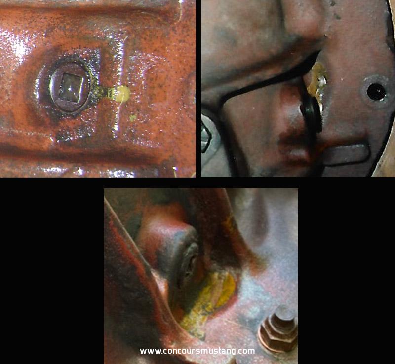

Here are some examples from unrestored cars. Appears that there is a large range (not really unexpected) of how much sealant a worker used or how neat they weren't.
Two 9" examples. Pictures are shown as they would look with the rearend installed in the car. Looks like the rearend was yoke up during the drying of the adhesive so if these were used to fill, on those 67s with both this fill and the rear housing fill, it was done with the rearend out of the car or filled through another opening

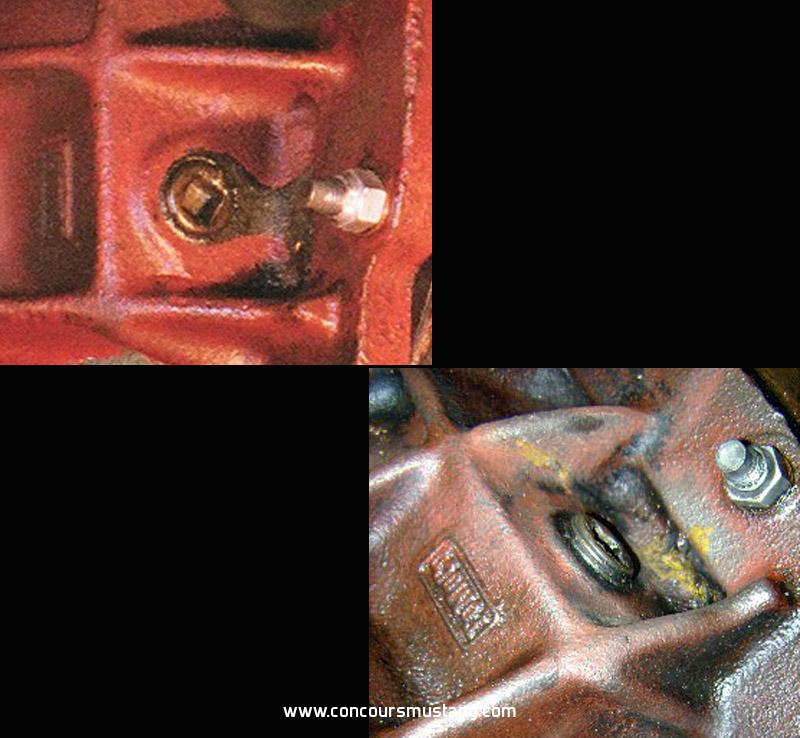

If we're going to expand to 68 also here are two more groups of examples. Like the 67's I posted it appears that the reaends were positioned yoke up as the sealant dried and possibly applied . The first are 8" third members showing that both yellow and possibly blackish or at least dark sealant was used on that line. Yellow sealant example is really messy. Bottom is the same one that Marti posted above Noticed this after assembling and posting
8" examples

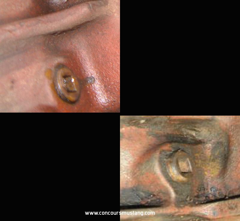

And some 9" examples from 68
Do have my fair share of 67 and 68 examples with no visible or just enough sealant used
