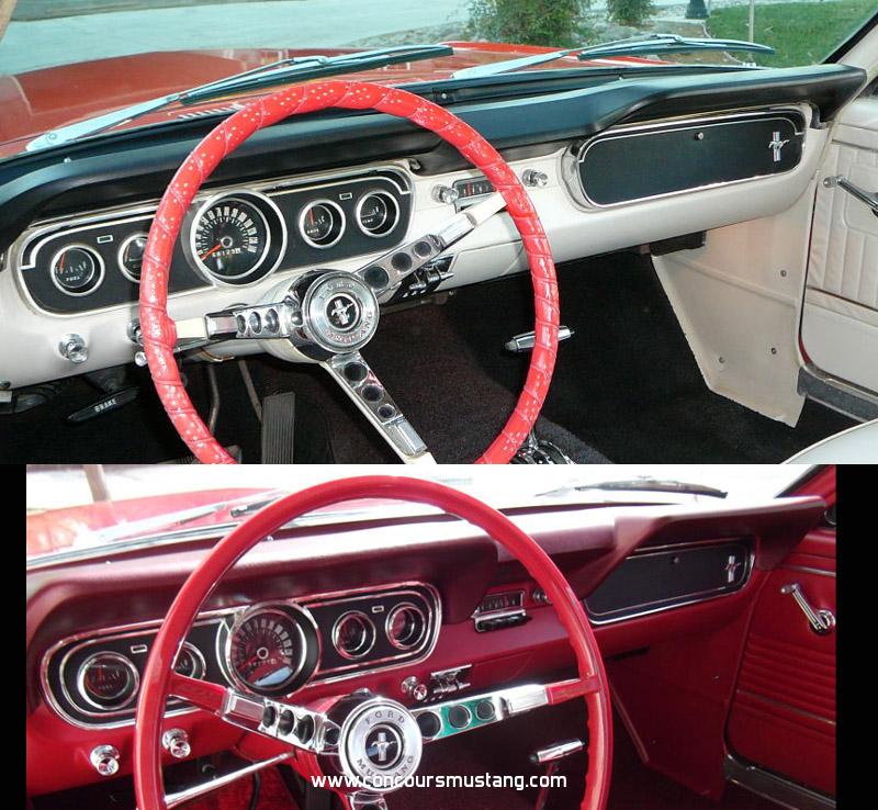

Yes some can get the two years and their differences confused with one another and many owners over time purchased and installed incorrect bezels when their originals got old with what ever was available at the time adding to the confusion. Many of our great members have already provided examples and input to guide you to the correct bezel for your need.
Non-deluxe (pony) interior 66's used the same bezel GT and non-GT since both had full gauges - a new feature that year.
Example below is (top) 65 GT bezel and glove box door - (below) 66 standard and standard interior GT bezel and glove box door

« Reply #4 on: September 13, 2019, 08:08:49 PM »
My cars original GT standard interior cluster bezel and glove box door was like the one Phill attached, normal camera case with full chrome circle.
Jason
Same for me
