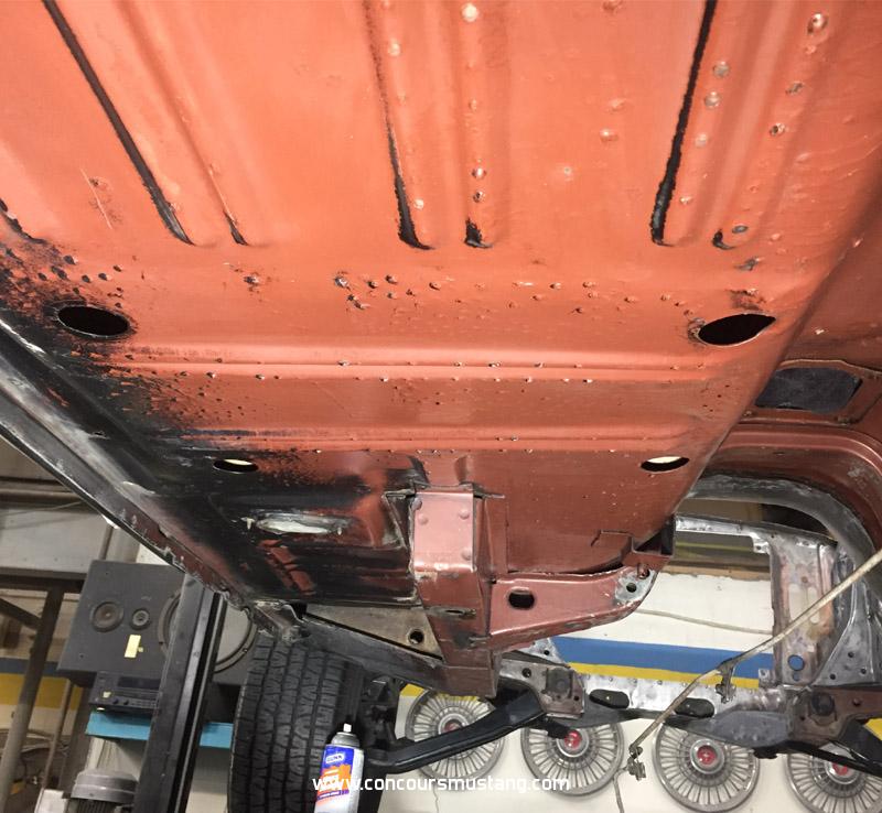

I just had my car media blasted and the underside drips and runs were so thick that the blaster could not get them off without being overly aggressive. The good news is the body of the car is perfect with no so much as a pin hole of rust. However the drips appear to have all been popped, as they were originally on the car, as if hollow inside. My concern is if I just paint over them that they will not look like fresh drips. Would it be better or more desirable to have sloppy looking drips like the factory or in keeping with a fresh restoration to have a cleaner finish. Some of the more subtle drips are now gone, but some of the really thick ones remain. I am on the fence and would like to know any thoughts or advice.

I would leave it, you are lucky to be able to save that original detail. Some times the drips popped when drying.

+1 , I would think this could save you a step of reproducing this detail. Lucky you!

Leave it and be prepare to spray a little heavy in that area to help accentuate and build on the original drip residue IMO.

Agree with the rest (too bad you could not save more) and leave them with the hope that they will collect the new paint coat and rebuild or collect in the same locations. Looks like you have any remaining rust addressed. And remember to check and address any damage that might have occurred with an off the road excursion possibly in the past

Thanks Jeff. Part of the reason I decided to strip the underside was because of that very reason. As you may recall a previous owner welded some traction bars on at some point and there were a few dents and small things like that that needed to be addressed, so all of that is taken car of now and I have a fresh slate to start with. While it is true that some of the drips are missing I am hoping that what is left over will yield a good result. Hopefully filling in the popped drips with a fresh application. I was actually expecting all of the drips and runs to be removed with the blasting, so this is actually bonus. Overall I am very happy with how clean and rust free the car is. A very pleasant surprise even though I suspected it was this clean. It's always nice to have confirmation and evidence.

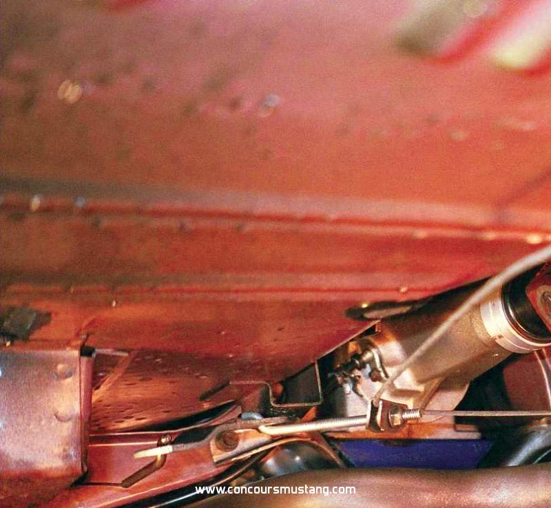

This is shot of the underside of my (sold down under) March 28 66 GT Fastback. There are a lot of "drips". It's not limited to a year.
Hi Jim is that all original?
Looks like a over coat/spray of rattle can (Rustoleum) red oxide

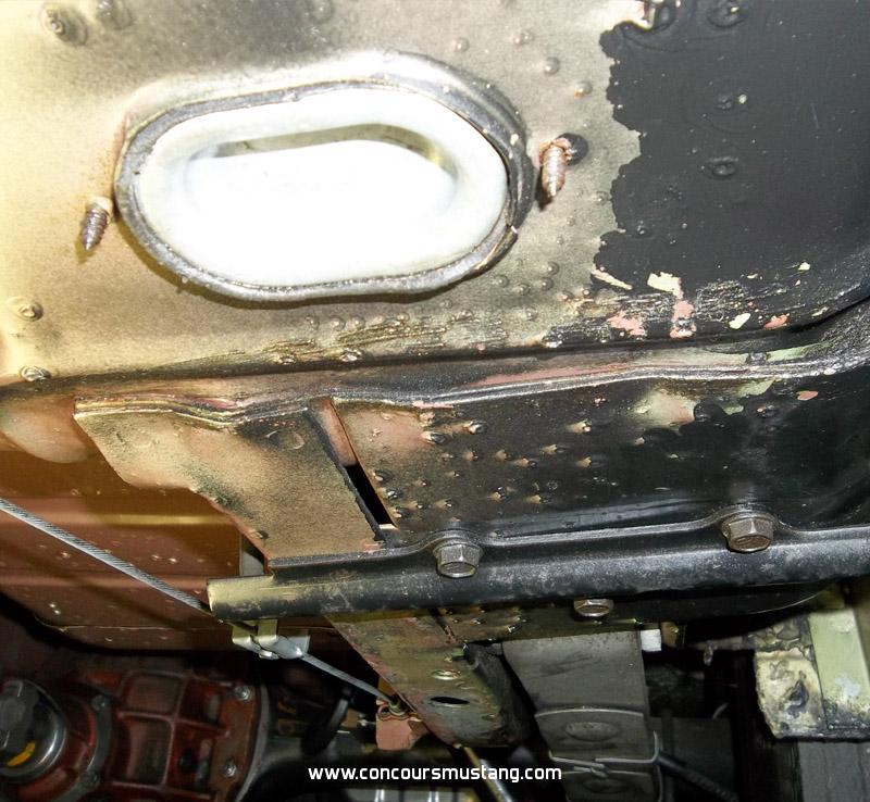

Some more examples from 68 San Jose cars built around the same time as yours 8R16xxxxx's. Somewhat deep and slightly shinny as expected. Have a fair number of examples ;)
I was thinking the same thing?
Re: 1968 San Jose GT 390 Fastback Factory Red Oxide underside drips
« Reply #14 on: October 26, 2019, 12:39:42 AM »
"Most" of that is. I cleaned the underside with soap and water to get the dirt off, then ran a rag with paint thinner over it for tar and grease spots removal. I looked at the results and headed off to Ace Hardware for a rattle-can of red Rustoleum primer (Home Depot didn't carry Rustoleum at that time). I was surprised that it was an exact match, so it became a "touch-up" job. The pinch weld was also "touched-up". I did cut into one of the drips as a test, it was very solid. All this was done in late 2000, early 2001, along with an engine rebuild.
