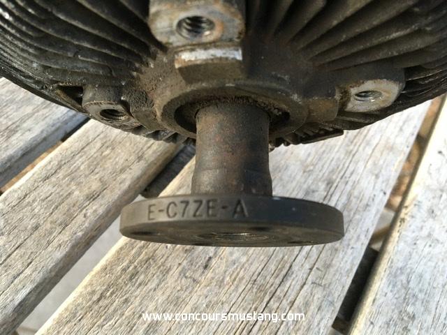

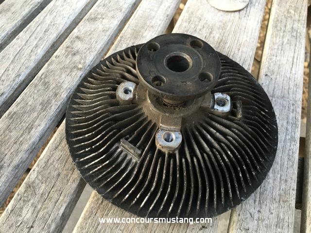

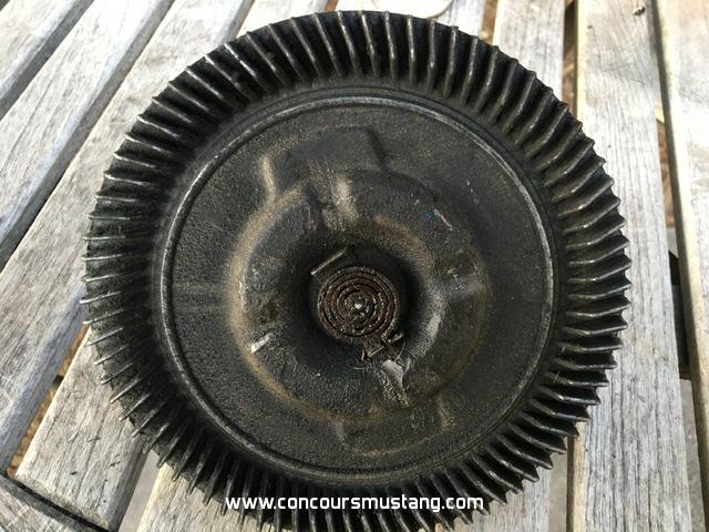

... The one stamped C7ZE-A 2.91" depth was used/service replacement for the 67 Mustang with 289 without the hang on AC before the 2/27 date
Resurrecting this 4-year thread.
The discussion relates to a current situation with my car.  The recent pics below are of the C7ZE-A fan clutch removed when replacing the leaking timing cover.  Because of evidence of leaking oil (hasn't been cleaned), this part wasn't reinstalled and we went with an aftermarket fan clutch.  This is a C-code car with AC and T/E, so it is equipped with the 7-blade clutch fan.
It's been difficult to determine whether this C7ZE-A fan clutch is still functional; however the car does seem to run a bit cooler with the new fan clutch installed.
Can this C7ZE-A fan clutch be rebuilt?  Looks like a "sealed unit" to me, so I'm guessing probably not (?).
« Last Edit: November 04, 2019, 11:27:46 AM by Deuce »
Deuce
Re: '67 289 with a/c fan clutch
« Reply #6 on: November 04, 2019, 02:43:35 PM »
A guy over at a Corvette site was rebuilding them. Try Pampered Corvette and see if it was them.
There are other threads about these here and maybe middle of the summer this year, it came up again.
  • Posts: 9535
« Reply #7 on: November 04, 2019, 06:29:03 PM »
Yes, they can be rebuilt but the guy that does them has a long lead time to get them rebuilt and cost and shipping is only a little less then the brand new almost exact repros that Chris Brown Classics makes.  http://www.brownsautobodyservices.com/classics  FYI it is not a inexpensive process regardless of which way you go.
