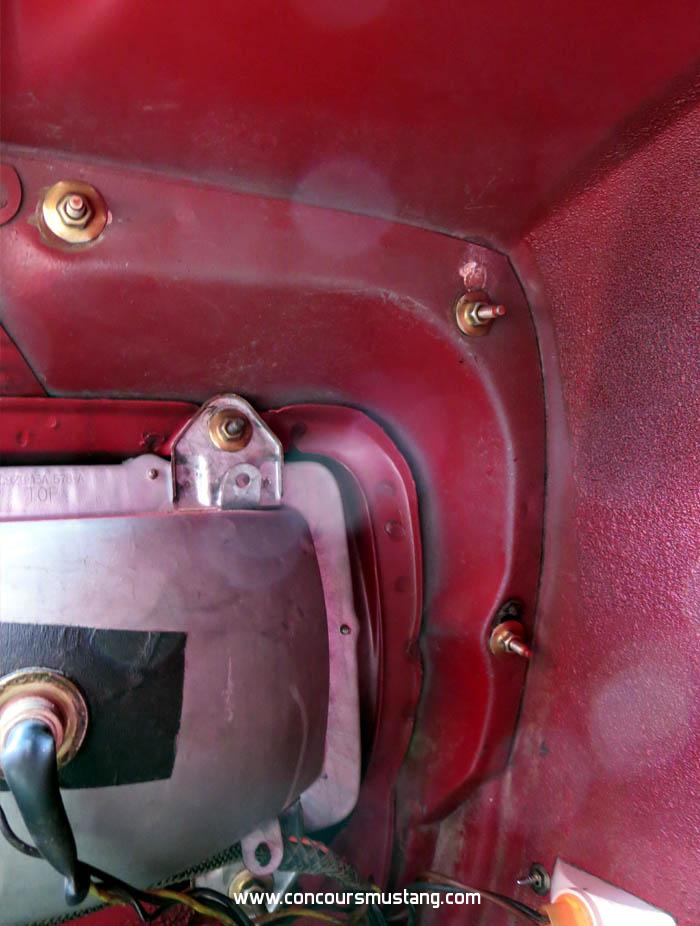

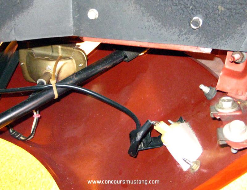

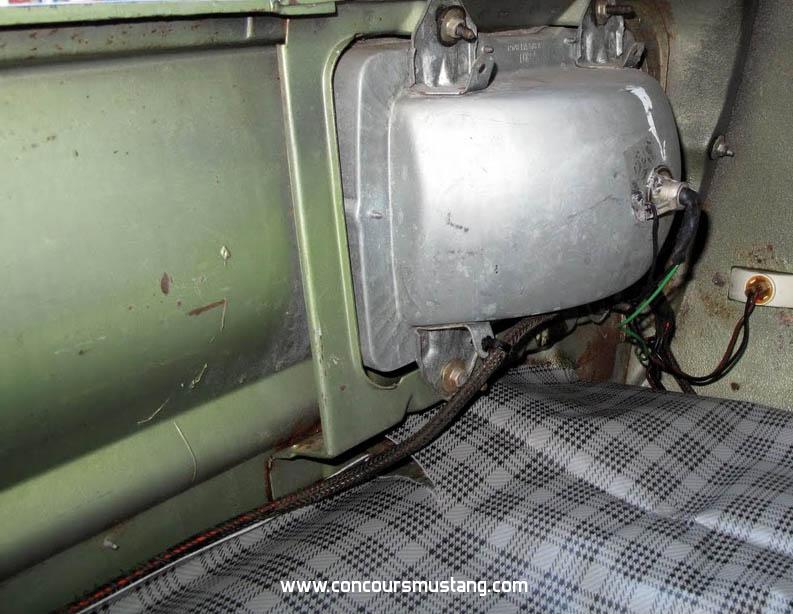

Pictures from the unrestored picture thread section of the site showing the rear mounted ones
Notice that for some reason the upper taillight nuts on the top example have sealant (which serves no real purpose that I can see)- yes I realize that its off topic but don't expect the discussion to take off. And if it does we'll split it
If your focusing on the front marker light then you will also have a wire retainer you will need to consider also that is held in place by the forward nut on both sides. You didn't include :( where and when your car was built so don't know how much of the details int he picture below apply but the example is a late Dearborn 69. Details often differ if your car was built during a different time period or plant

Since you mention the car being a San Jose car need to share that I've not yet found one used on a 69 built there. Not sure why but wanted to report the lack of findings for that plant and year. Also don't have any examples with the zip tie we find on some others in the wheel well built at other plants
With the number and possible wide variety of headlight and front side marker wiring and retainers this might be a good subject for another thread just focusing on those to see what we may be able to figure out
