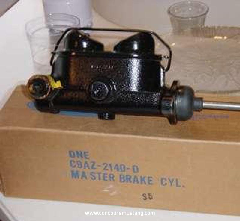

Here is a picture of a NOS one.  No Bendix or stop bolts on the bottom - just a few cast in non-descript numbers and a date code.

Thank you for the picture.
Seems as though I can find just about any configuration on these.  I will try to find the closest one and focus and the cap now.  I believe the cap and bowls should be the same size.

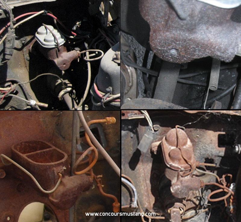

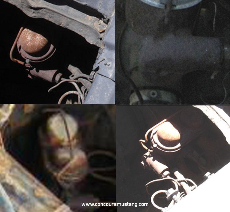

« Reply #6 on: February 17, 2020, 09:50:11 PM »
As promissed
Focusing in this post on the end of the master cylinder and the lack of the raised dot you referred to in your original post

« Reply #7 on: February 17, 2020, 09:54:43 PM »
And an example of a service replacement C9AZ-2140-D like the one Jim posted.
Stamped number and markings on the side of the main case is not a Ford number. In some cases it appears to be a possible assembly date and identification for Bendix in house purposes
These appear to be very similar to the ones used in 67 & 68 for manual drum brake cars
