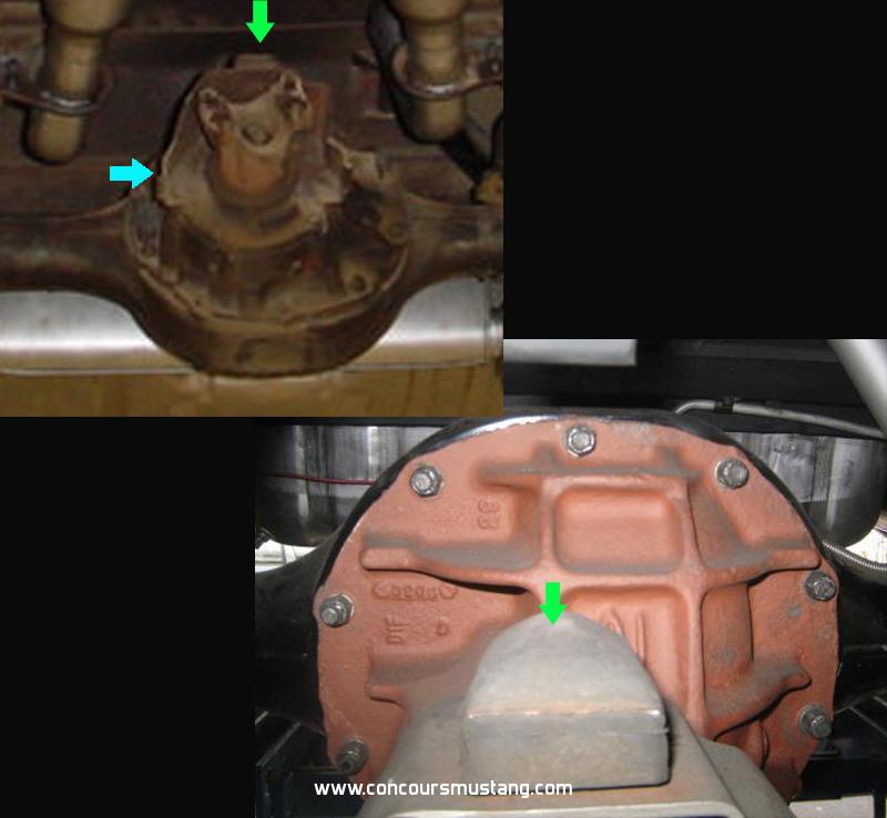

I did add the following above in my earlier response
The direct answer for a 69 with an H engine code or greater performance or cubic inches no there would not be a rubber snubber/bumper attached to the floor brace. Instead it would be attached to the snubber bracket attached to the third member of the rearend. The snubber has a threaded mounting stud and is retained by a nut accessible from the yoke side of the bracket
Here are a couple of pictures. Blue arrow - the snubber bracket and the green arrow the rubber snubber
« Last Edit: April 01, 2020, 06:27:09 PM by J_Speegle »

« Reply #5 on: April 01, 2020, 06:29:14 PM »
Thanks.  This forum is extremely helpful, even though this car will never be concourse, I am putting things back as they should be.
