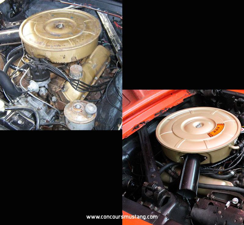

Sure many of the early car member will know some of the vehicles that air cleaner was originally installed on. Have seen allot of them swapped onto early Mustangs over the many years of ownership. I recall them on some falcons and early Fairlane's I think
Here are some original air cleaners for you to compare from the cars production period

The first picture of an air cleaner show the "rare" version of early Mustangs (64 thru 66), it has no fitting for a hose to the driver's side valve cover (PCV connection), picture 2 does. There is a third version, one with a third fitting at the rear for California smog (all 67 small blocks used this type).

Those Fairlane style air cleaners are not even physically compatible with a Mustang.  The snorkel will rub the bottom of the hood when installed.
The correct air cleaner is the 17" style as Jeff posted pics of.  There is a slight variation of that one on very early 64 1/2's that has a nipple on the bottom for the choke vacuum chamber hose.  I only mention it in case you're offered a '64 1/2' air cleaner as that version would not be correct for a June 260/289  It's identical once installed, but not correct for your car.
Date stamps are stamped on the base and snorkel, you'd probably be looking for something with 4E or 4F.
Also, make sure you use the right 289 decal, the D code 289 was not a premium fuel 289 like the later 'A' code.
