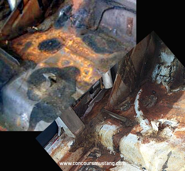

This was just park of the running change that followed the emergency brake routing running change. Sure the date on the panel ( passenger side rear edge) will confirm when the panel was stamped.  Very late 65's got the changed floor panel that was used up into 67 when it changed again.
Comparison
Late 5F7977xx in the upper left hand corner and just a slightly earlier built (likely) of 5F737xx in the lower right corner Notice the lack of the raised "tunnel" or channel for the earlier E brake cable routing
Hope this helps and explains clearly
