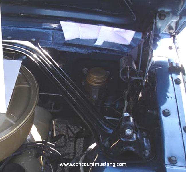

All these cars received export braces, thus the name “export brace”. It also has an angle iron welded to the cowl where the brace attaches. Similar to what is found on the 65 Shelby only the holes for the bolt would not be equally spaced like they would be on the 65 Shelby. Have seen the angle iron on one other 65 Blue Mustang de Me ico.

The "angle iron" was part of the export package and required/added for the export brace attachment and done by Ford. Same practice done on other exports that year and the holes were redrilled to match the equally spaced export braces that were part of the export and Shelby package in 65-66. Believe you will find that there was only one design for export braces for Mustangs & Shelby's originally in 65 & 66.
Picture of the blue car that was around a few years back
Took an export brace off of a 6 cylinder export car years ago in a yard - had the cowl bracing as expected. Also found on on an export falcon - those are difficult to find. Only one I ever did.
