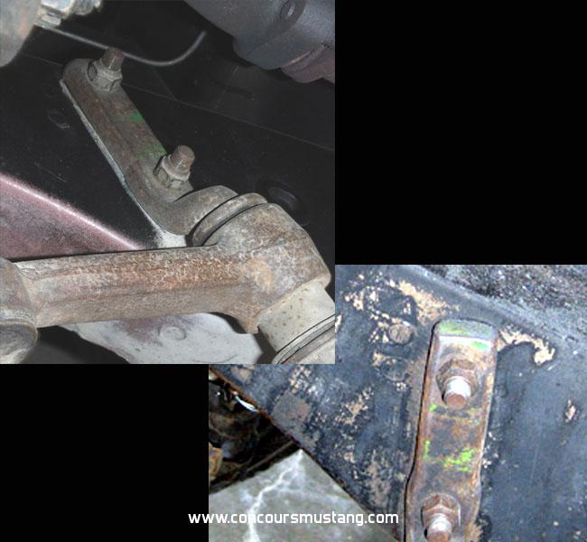

PS Idler arm - May be blue. Earlier discussion http://www.concoursmustang.com/forum/index.php?topic=597.msg3025#msg3025
Idler arm frame mount - One or two green stripes

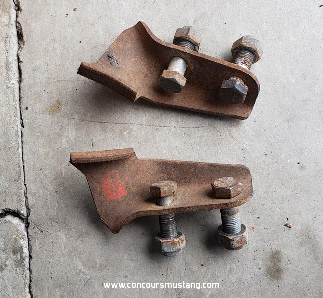

Steering stops - Red daubs (earlier threads had responses found on one or both during 65-66 V8 production)

I found light blue on most of my tie rods and except the outer passenger side one (power steering car). Nothing conclusive on that one. My car is 10/29/64. I only found a red daub on the driver side steering stop on both my fastbacks. Nothing on the passenger side.
