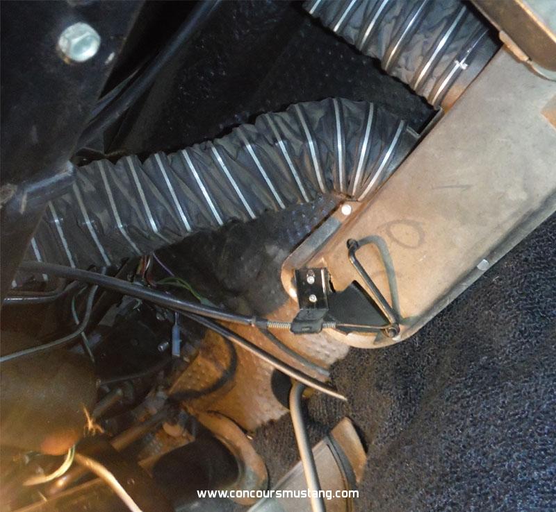

Re: Heater Box Rebuild
« Reply #5 on: April 19, 2020, 04:32:46 PM »
An example from an original car to illustrate the original shape of the defroster hose
