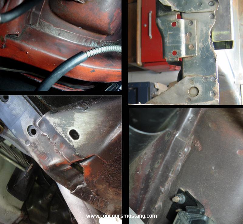

Your likely not going to be able to reach or see many of the areas that would show the original color without lifting the car and doing some cleaning. Over the rearend, under the edge of the seat mount plugs (as mentioned)  and along the bottom of the frame rails just behind the shock towers are often places to start. With out cleaning and even a little investigation you may see body color or a mix of it and what lays below and not the true base color. This will be the most certain way to figure out what color those areas were and provide you something to match to. Once we get there we can discuss sealers at the seat belt anchors, rocker to floor seams, trunk drops and then sound deadener which will/did cover approx 50% of the main floor area as a final coat.
Some examples below
Just confirming your car is 0R02M1188xx with a completion date of  11/13/69
