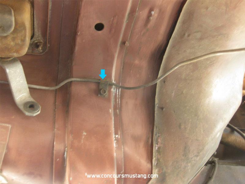

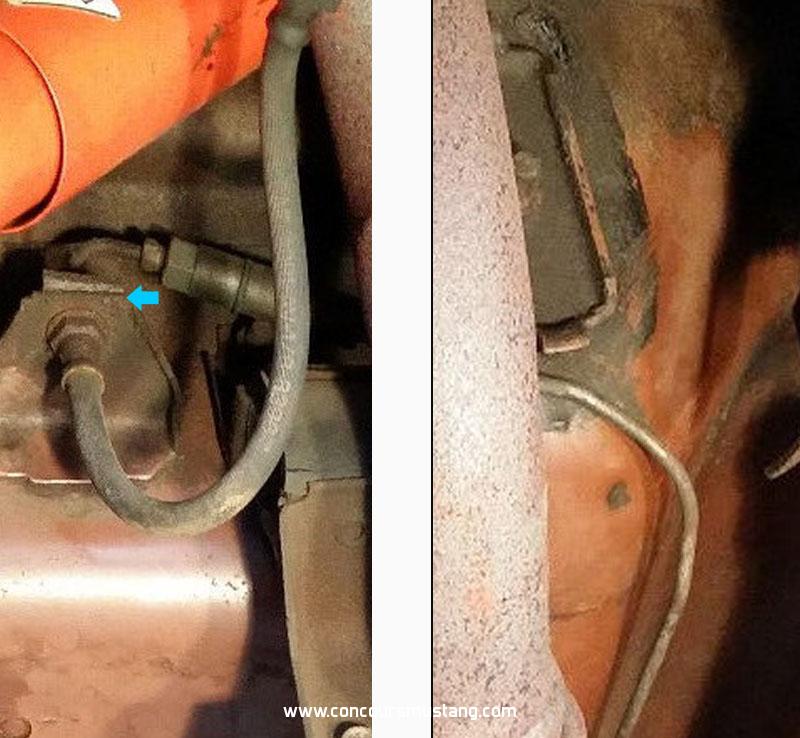

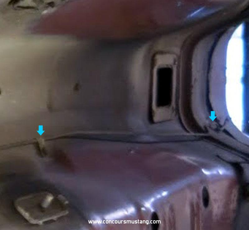

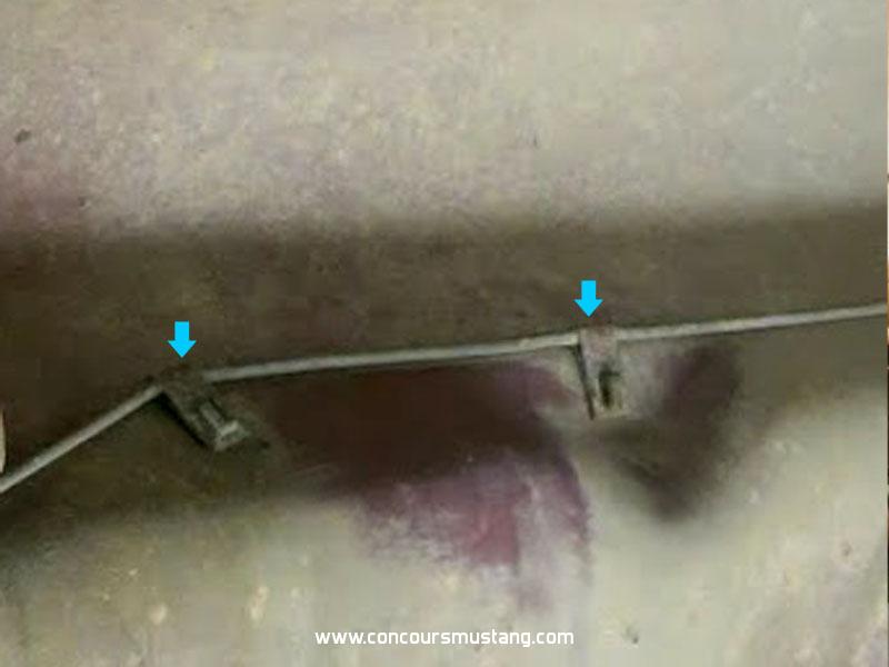

I am trying to determine the correct locations of mounting hardware of the the fuel and brake line. Specifically for a later 67 with the  2 piece fuel line, routed through the frame rail by the drivers seat,  the brake line line is going under the steering column. I dont see the correct mounting locations for the brake line in the tunnel. Any and all pictures would be greatly appreciated- Thank you!

« Reply #3 on: July 12, 2020, 09:04:26 PM »
Reusing the lower drivers side firewall picture from the other thread going rearward to the rear brake flex line.
Sometimes that rear bend at the rear edge of the floor board and tunnel will head up and across the face of the rear inner seat belt anchor with a slight S turn/bend
