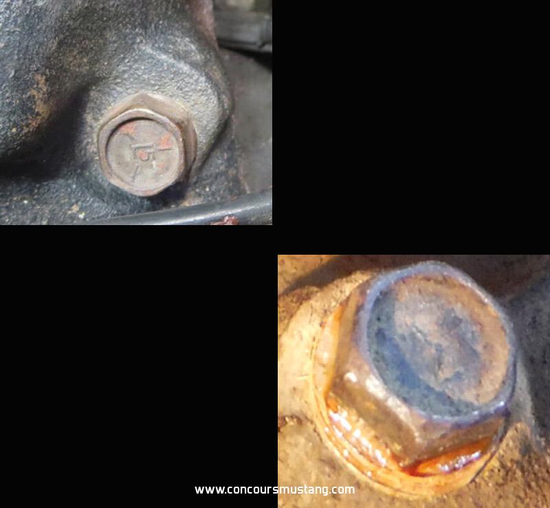

All bolts with a very thin washer on each to help seal. Studs were used in later years and other applications
Though you didn't share when the engine was assembled here are two pictures. Upper left shows a commonly found head marking and the lower right shows the very think metal washer better

You need 12 each of Ford hardware part number 378484-S99. Each bolt comes with a nitrile (rubber) covered rubber sealing washer, 0.031in thk. They are available from AMK Products - www.amkproducts.com - under their stock number B-12508, which is a pack of 4, you will need 3 packs.

One more point. The bolts and washers are painted engine color after the intake manifold is installed.
