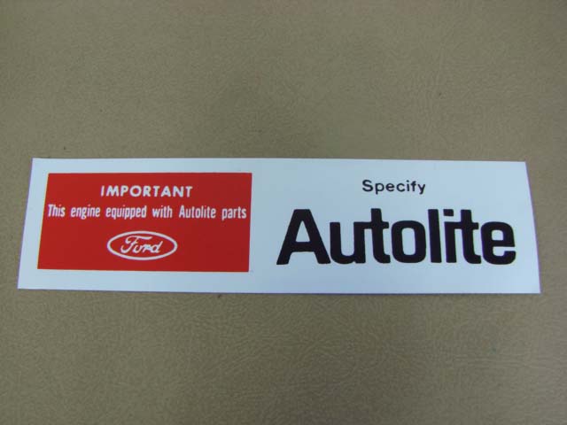

Bottom decal is generic air cleaner decal, most were specific to engine air cleaner size
Pretty sure assembly manuals give specific information but looking at original cars near yours would be best source for information

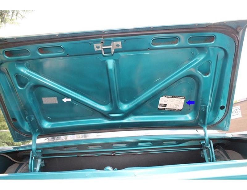

For the Service/ Maintenance decal here are some examples from the same production period as your car plus or minus two weeks
Trunk lid for locations of your two trunk decal
Engine compartment
Yellow - Battery inspection. Will need to be filled out.
Purple - Another service sticker location
Red - Cubic inch decal
Light green - Air filter replacement
Light blue - Emission sticker
Yellow - Engine ID sticker
