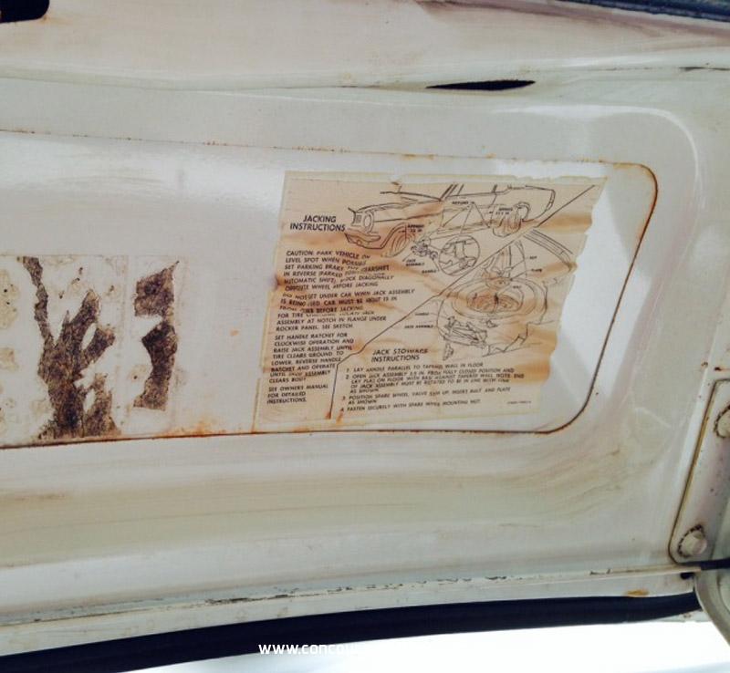

By far, the most typical would be on the RH side.
+1 Drivers side is a very rare occasion in my experience. In fact have never found on on an original there
Example from your cars time period. Ignore the other decal location where the decal/sticker is now long gone. That is a Shelby specific decal
