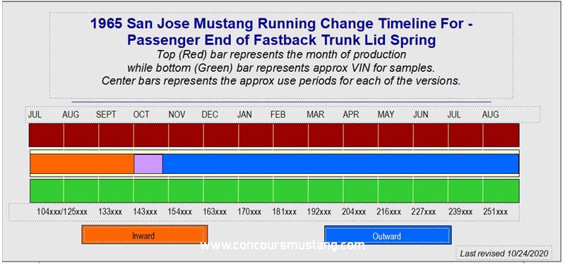

Passenger End of the Fastback Trunk Lid Spring -
In the survey the highest San Jose sequential numbered example with the inward pointed passenger end was -5R09C142xxx
The lowest sequential number example with the outward bent trunk lid spring found was - 5R09C1508xx.
A difference of about 8,000 units most of them being unrelated (to the subject) coupes.
Should be mentioned that the change also affected how the spring was held to the lower arm. Changing from the otter key retainer to the round toothed disc.
NOTICE that these two features appear to have changed at or just about the same time in production according to current findings
