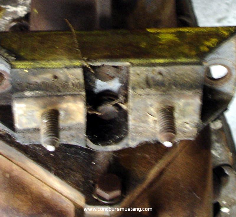

Would suggest that Max's pictures of head markings not be used as reliable resource as to head markings for any specific plant or time. But that just me and my experiences.
Have seen those head markings but don't have records of from where
As for finding a picture in my files of them on a transmission or car you are correct but always welling to spend some time to look
Only think I currently could find was an out of focus shot and even if it was clear there is likely too much build up on the head markings to tell. Since they are sunken in the picture I think a digital camera would have focused on the closer mount than the bolt heads :(
