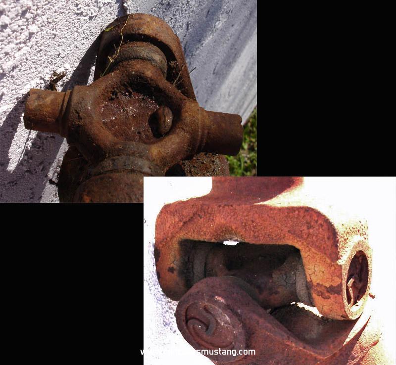

Does anyone have pictures of how the original U-Joints from 1966.

Here are two examples taken at yards of originals installed in 66 San Jose examples. Have 67's also with the same sunken center with no grease fitting or provision
Please ignore the snail in/on the upper example :)  Should have knocked him out before the picture was taken
Going to move this thread over to the 66 section since the information and question are specifically focused on 1966 production
