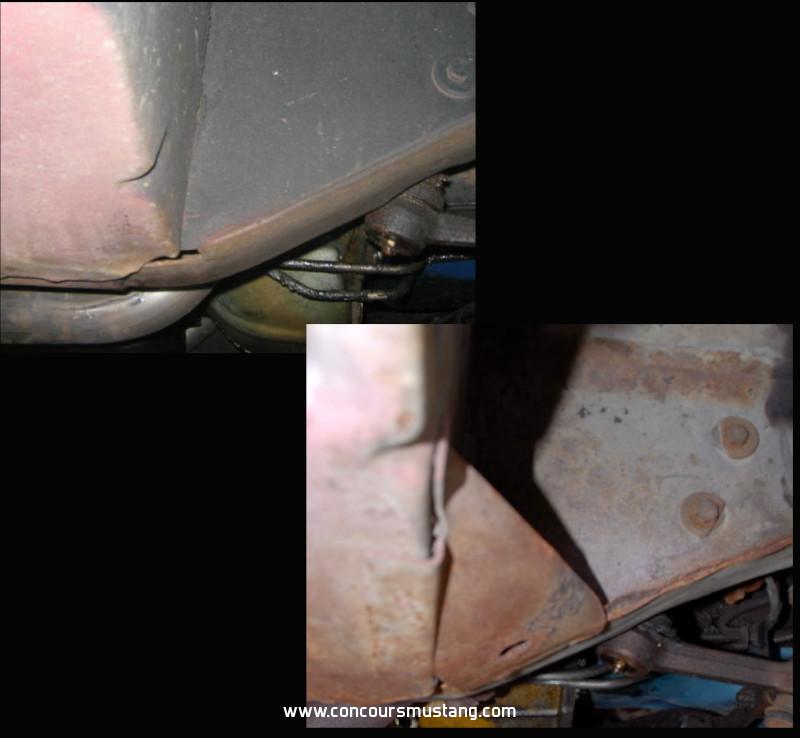

For others viewing the thread here is a picture of the area with and without the "gusset" referred to in the OP's question
Given our focus here and our intent there is no reason why I would want to leave something that should not be there or installed on my car..
