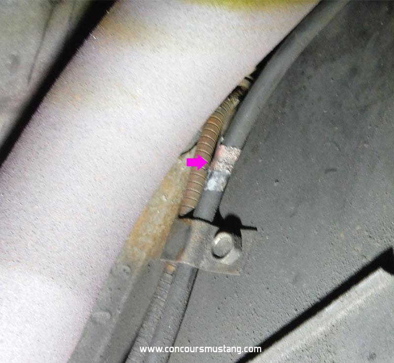

Attached photo with remains of tape on the cable - also with clip at lower throttle bracket.
67 Coupe SJ 11/16/66
67 GT350 SJ 2/01/67

................ The clip over by the hood hinge is a shortened version of the driver side floor pan one, only has the larger end.  The toe board and inner fender clip are made of spring steel.
To illustrate

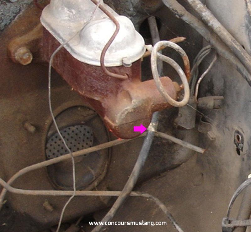

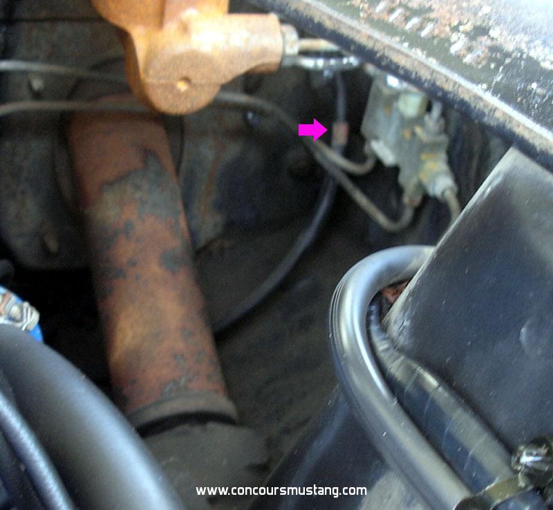

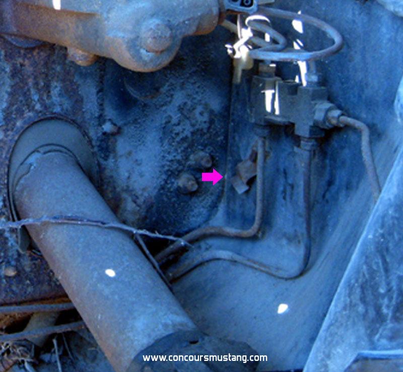

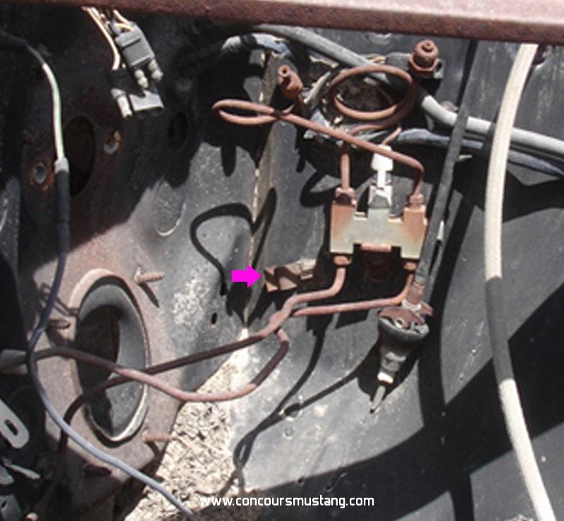

............. Any evidence of the tape seen on survivors or unrestored cars? I've been reading these and SAAC forums for a few years now and can't recall anyones posted engine compartment pictures being called out for missing speedo tape. Brian
Yes - location, color and so on dependent (it appears) on application and location
Couple of automatic examples at drivers side of firewall
Automatic speedo cable at drivers side front frame rail.
Sure I have more but just went through my non-Shelby San Jose pictures and not all the rest
Often it goes unnoticed as there is normally so much more important details that need focusing on when reviewing and commenting on someones engine compartment plus often hidden from view - especially on a power brake car.   ;)

To illustrate
Here it is out in the open. spring steel color or black dichromate and cad colored spreader clip:
I should add that I have this clip on my March automatic parts car as well as on the Shelby 4 speed car.
