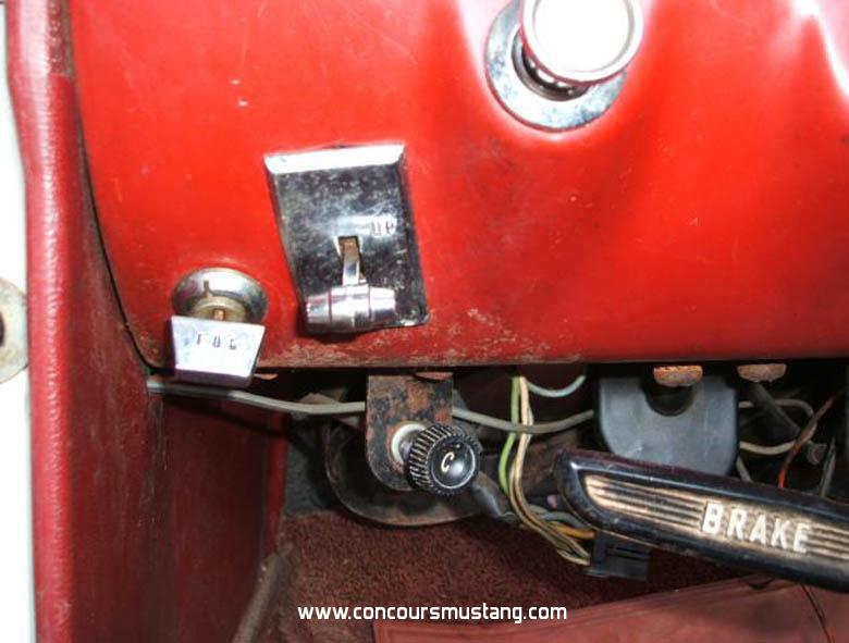

For those who did a search and came up with this thread while looking for information for their factory GT power top convertible below is a picture of what is/was an original GT with power top example built in Dearborn 6F08K113xxx

The hole/switch would not go anywhere since the GT option was not available in Sept 64 when the car was built. Of course unless it is a A or K code it wouldn't be one either  ;)
For those who did a search and came up with this thread while looking for information for their factory GT power top convertible below is a picture of what is/was an original GT with power top example built in Dearborn 6F08A113xxx
A "C" for choke on an "A" for engine car?
I did a quick eyeball on my 66 "K" Fastback and the Fog Light Switch is located very close to the one in the picture. I note that the convertible top switch bezel is a bit off vertical (camera?) and there appears to be part of the mounting hole visible.
You are going to have to drill a hole so make sure there is nothing behind the hole that may get damaged. Mask, measure, mark, eyeball and measure again.
