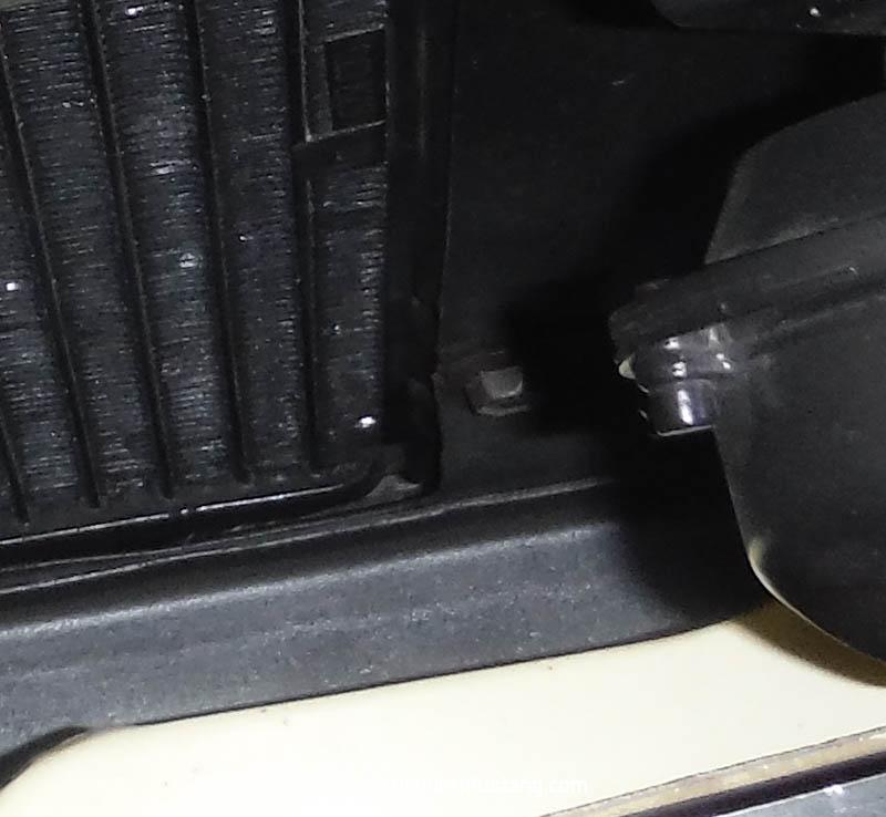

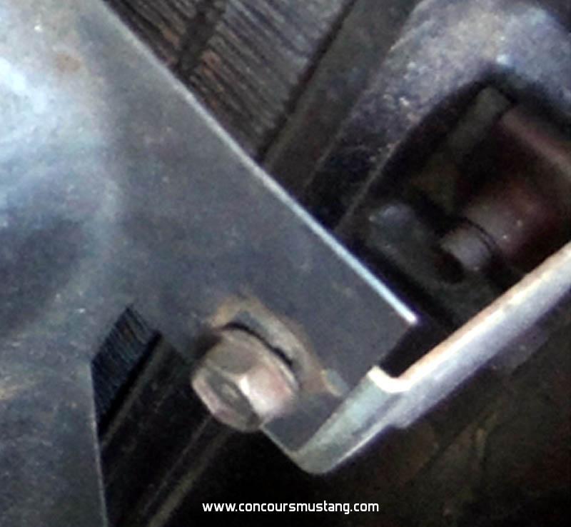

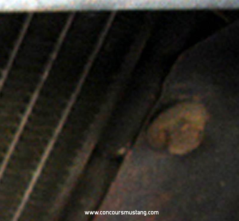

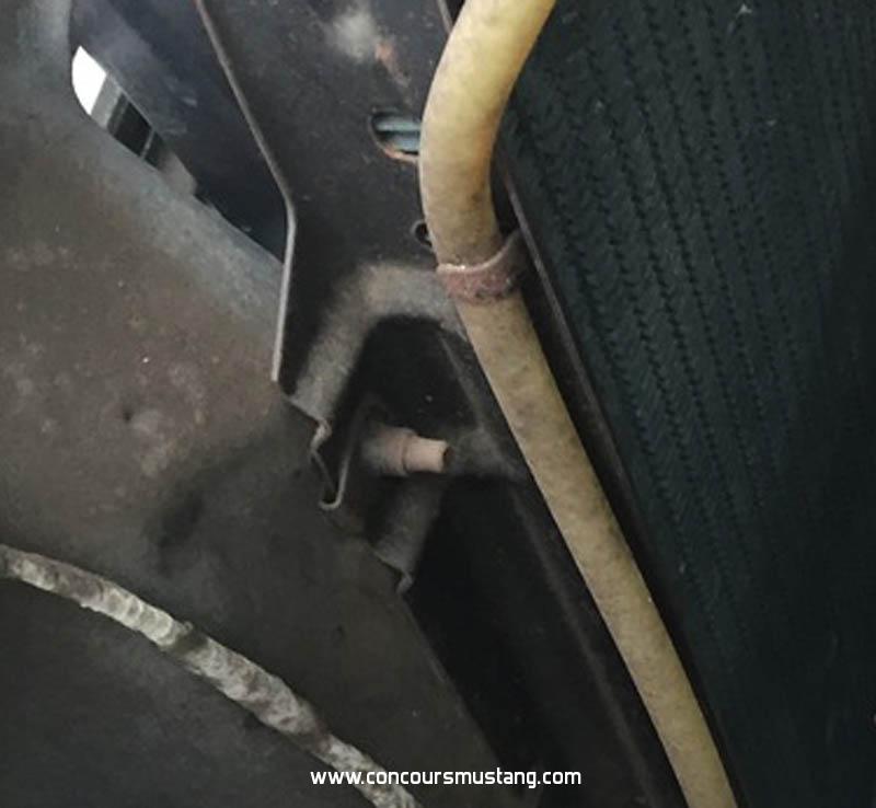

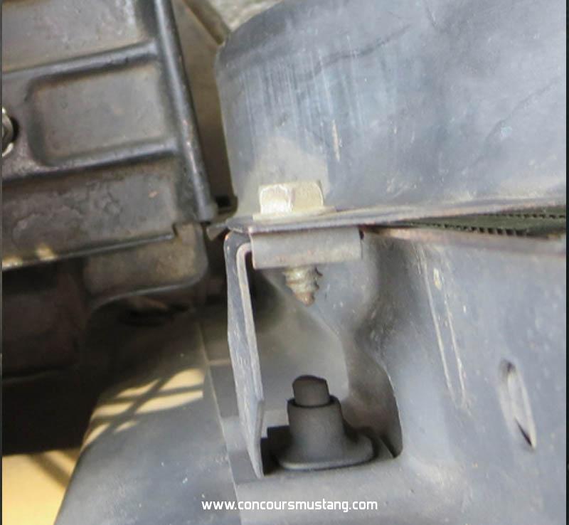

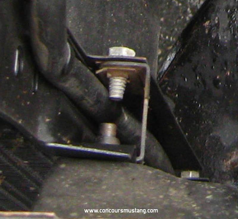

Did a survey for a current restoration and thought I should share the findings to help others in their efforts now or later.
Focus for this one was the bolt that holds the radiator in place and to the radiator support
Went though my picture collect, ignored any example with a replaced radiator since there was a possibility that the original hardware might not be reused or it would be installed from a different direction than originally found.  Of course some of the examples may have had the radiator removed and repaired over the years and that may explain the small number of examples that did not match the vast majority.
What I came up with is a bolt with an intergrated washer (one piece - washer part of the head design) installed from the front of the vehicle. Head visible through the grill. 90% of the examples were found with this orientation. The included both cars originally equipped with shrouds and without which sort of makes sense that workers assigned to this task would find what worked for their station and repeat again and again
Hope this helps others.
I've included just some of the examples (spaced out through the production year) below.
6R120xx
6R1377xx
6R1693xx
6R178xx
6R1963xx
6R2043xx

Pictures 1, 4 and 5 only show the tip of the 5/16 screw, the prominent feature is the fan shroud screw.
Picture 2 shows the hex head of either 359121-S42 or 378180-S2, as above.
Picture 3 shows a tip.
Picture 6 appears to show a different head.
Confirming the direction - one of the two things I was doing with the survey and the reason I choose to show that rather than just the head side ;)
Don't believe so. Know that car well and its the same as the one shown marked 6R1377xx

Picture 2 is the head style (sans marking) of both styles of screws I listed. Direction would be dependent on whether the nut clip was attached to the radiator or the radiator support. A "pre-assembly" step would attach the nut clips to the radiator, or to the shroud bracket, then the screw would come in from the front. If that was the assembly procedure, the radiator would be pre-identified as to a shroud requirement ("K" or A/C).
Picture 6 has a "thin" washer flange, barely visible.
Well yes and no. There were three options depending on year and plant if equipped with a shroud and two if the car was not equipped with a shroud
Believe it is more pronounce the dark picture and the low contrast I think minimizes the look. Easy enough to get access and compare side by side with other examples.
