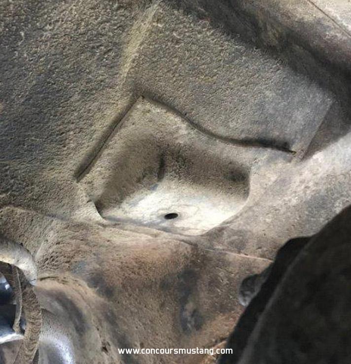

I am needing info on the part that bolts to the snubber plate that is spot welded to the underside of the body that the axle snubber bumps in to when bottoming out out. See pics.... the piece in question is held in place by 2 bolts and looks like a piece of angle iron.
Any info appreciated.

Hipo Mustangs do not come from the factory with anything bolted to that upper plate. Instead there is a metal pinion shield with bolted on rubber snubber that is bolted to the removable 9 inch center section of the 9 inch axle housing.

Now to some pictures.  Here are some examples of 65 K code snubber brackets as attached at Dearborn to the unibody over the rear end center point
Early 5F160xxx - Mid 5F330xxx - Late 5F622xxxc
Notice that they are shapped differently than the examples you found on the internet. The also have only one hole in the middle and no provision for the 8 inch style bumper to be attached to them
Pictures of the subber bracket typically attached to the pinion retainer bolts at the front of the third member
