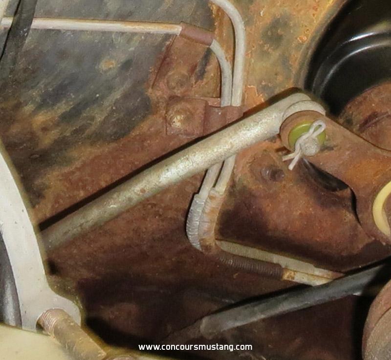

Re: Help with correct finish on automatic shifter linkage rods.
« Reply #2 on: February 09, 2022, 08:29:42 PM »
All I can offer. At least on the lock out it may have been zinc dichromate and over years lost the gold dye or just cad.  from two different unrestored cars
