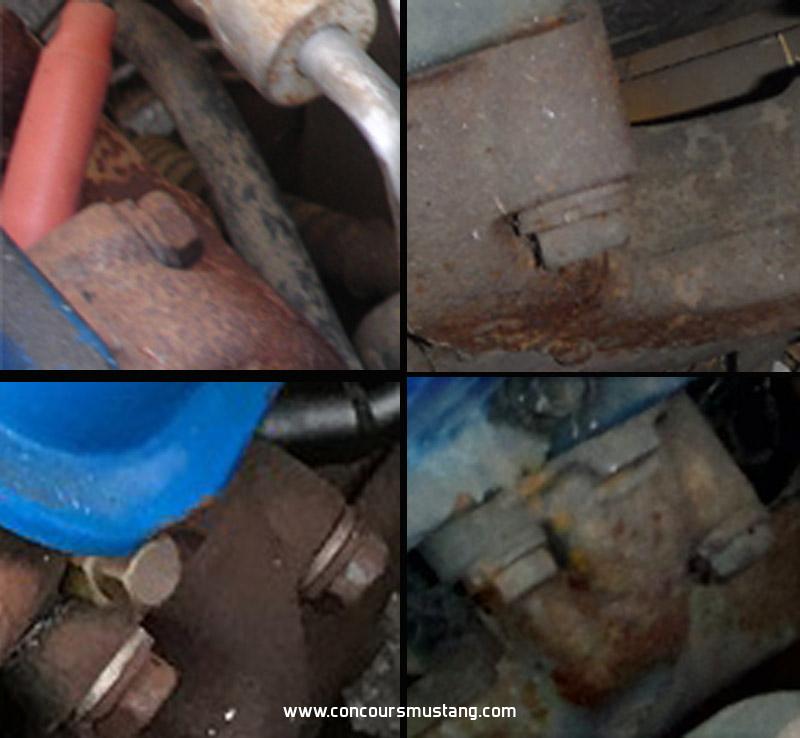

Re: 67 HiPo Exhaust Manifold Hardware
« Reply #5 on: March 01, 2022, 01:10:46 AM »
Though you can from time to time find a washer missing - not Fords intent nor typical - Just saying :)
A few examples showing the flat washers
