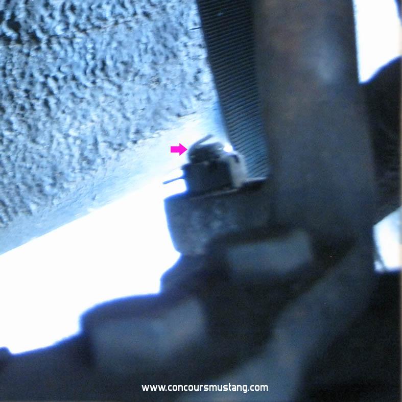

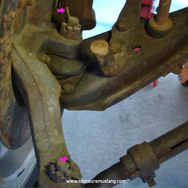

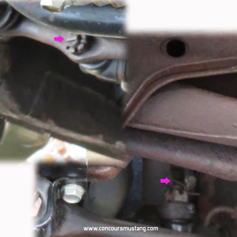

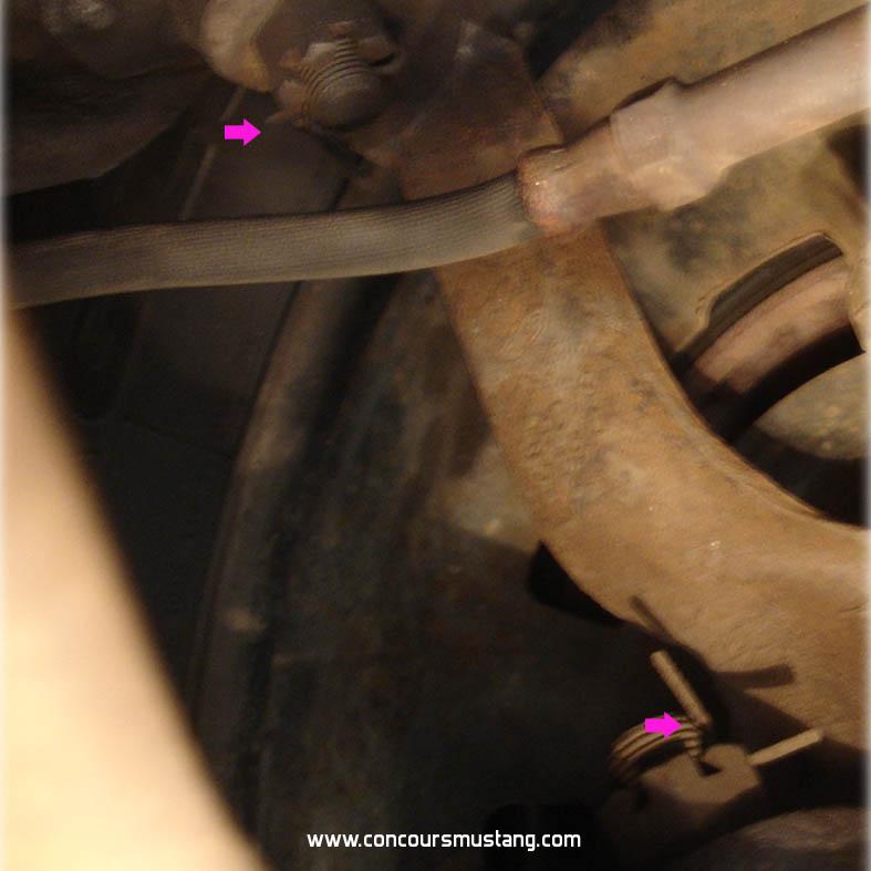

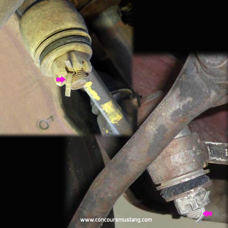

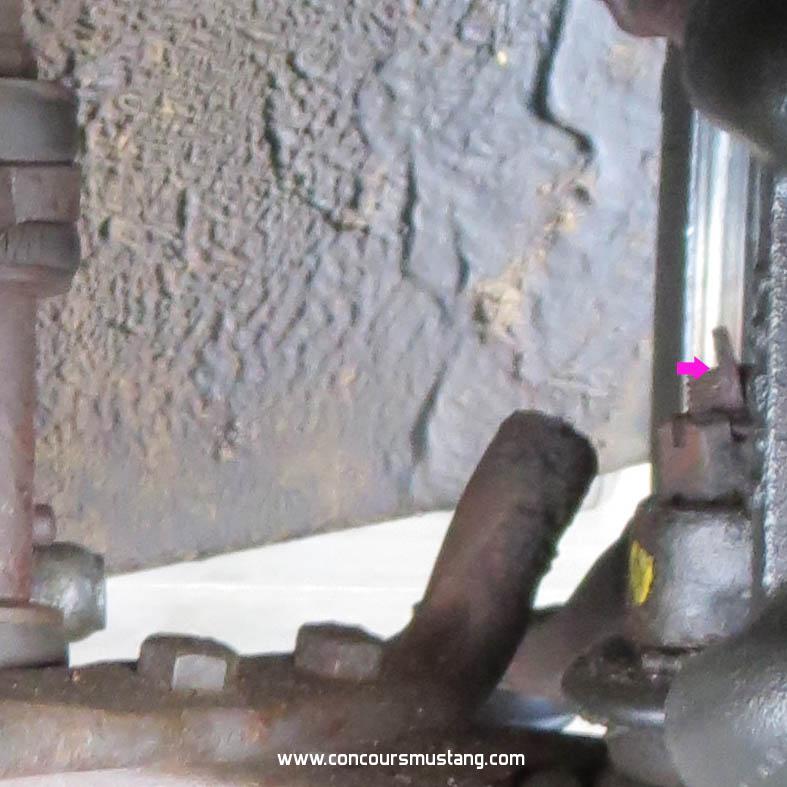

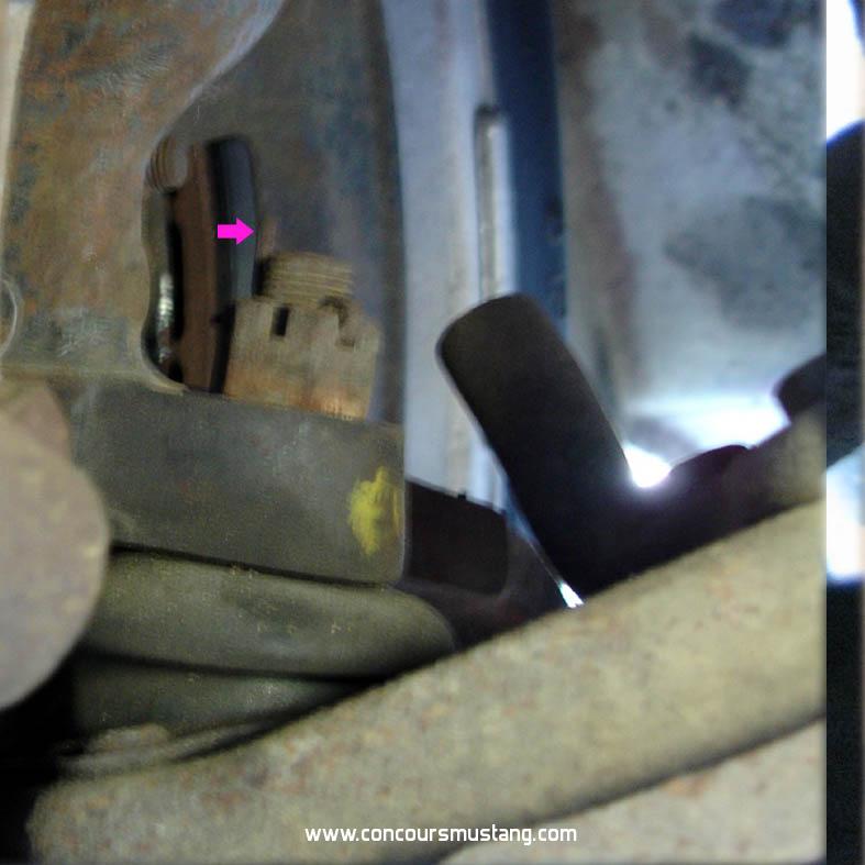

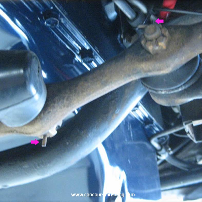

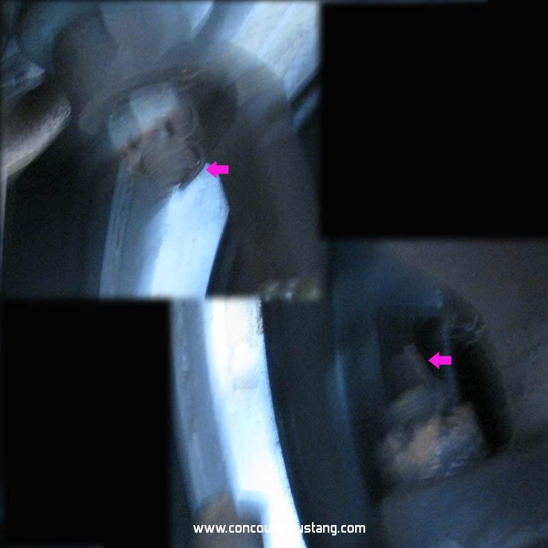

« Reply #3 on: April 06, 2016, 05:50:22 PM »
Ok found at least 20-30 original examples and stopped there since it was pretty consistent
The big things appears to be to have the right length cotter pins so that the ends are not too long.
It appears in a effort to save time the workers (most of the time) only bent one "leg"  of the pin - over the nut and onto the top of the stud. We can see that some have gotten tilted or loosened over the years possibly by twisting or someone hitting or the pin grabbing someones shirt, arm or what ever while servicing the car. At the a arm I found allot (maybe one or two of the regularly assigned workers fro that position)where the one bent leg of the pin was just bent upward - again someone saving so effort - not likely what Ford wanted but that is the way it turned out
What I found - on unrestored 67 Mustangs built at San Jose through the whole production period
Hope it answers your question

Would it be correct to say the longest leg of the cotter pin was folded over the top?
In a number of pictures it's hard to compare how different in length two were originally but in a couple of those shorts above it does appear that the longer leg is the one inserted into the hole on top and then bent over the stud
