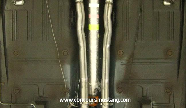

Did copy the location and direction of all the clamps from other original cars I had pictures of.
Not that the driveline has been restored and in the pictures wrapped with plastic wrap at the moment

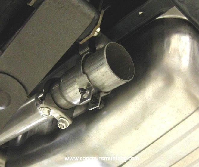

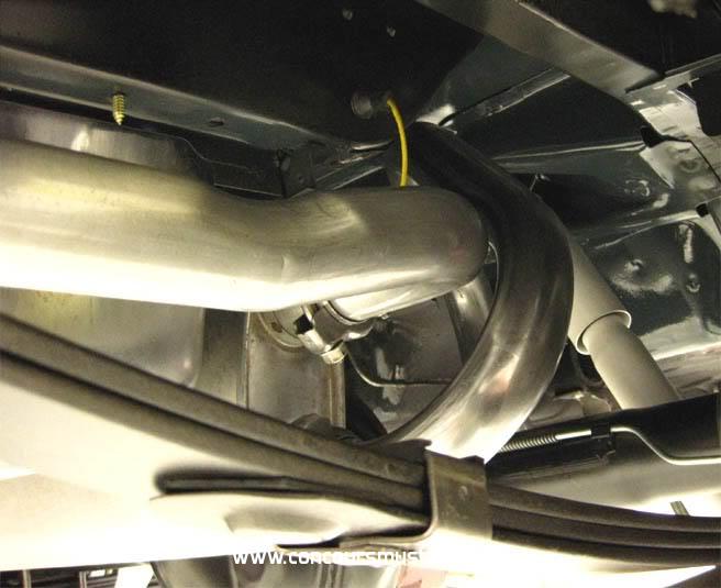

Rear adapter from tail pipe to collector used on the GT350's

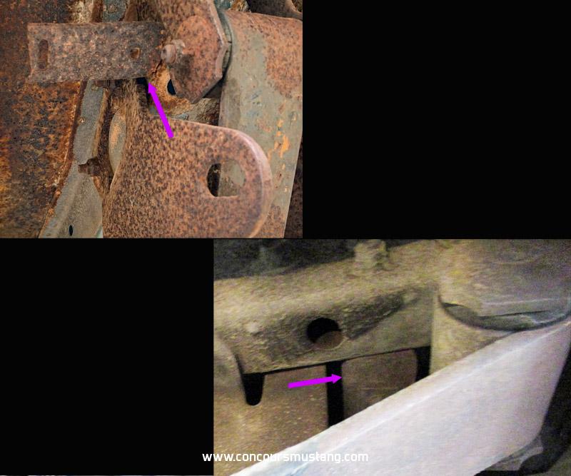

The index tab and cut out

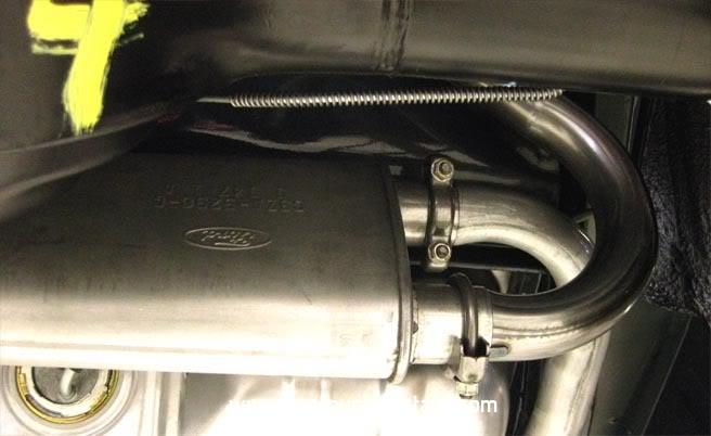

A shot of the muffler stamping (car will be shown in Concours trailered and Div II (SAAC) classes so date is not important - and yes the stamping should be on the front ;)

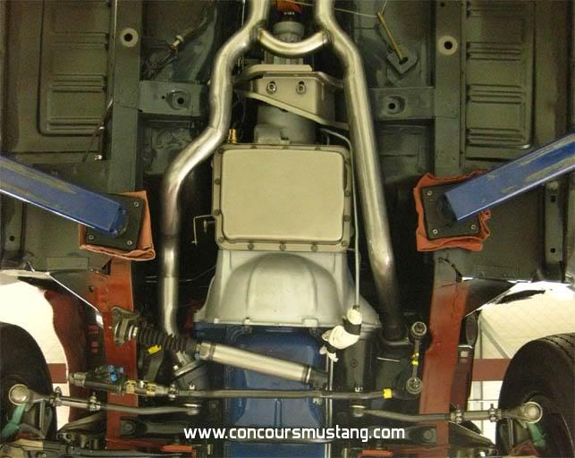

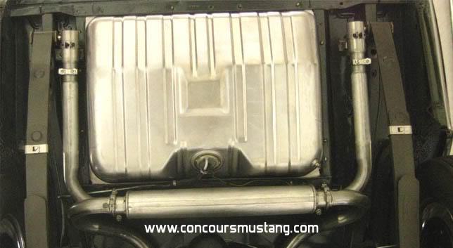

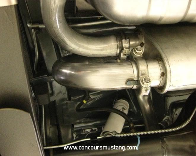

Everything wraps and bends around other items so nicely
Scott test fit the whole system together at his place (we shipped the muffler to him) to assure everything will fit just right. Of course no two cars are exactly alike so we had to help it just a little so that all the indicators and stops aligned just as they should.
Very happy with the look and fit of the system.  Believe we got the second 69-70 GT 350 system  he has done.

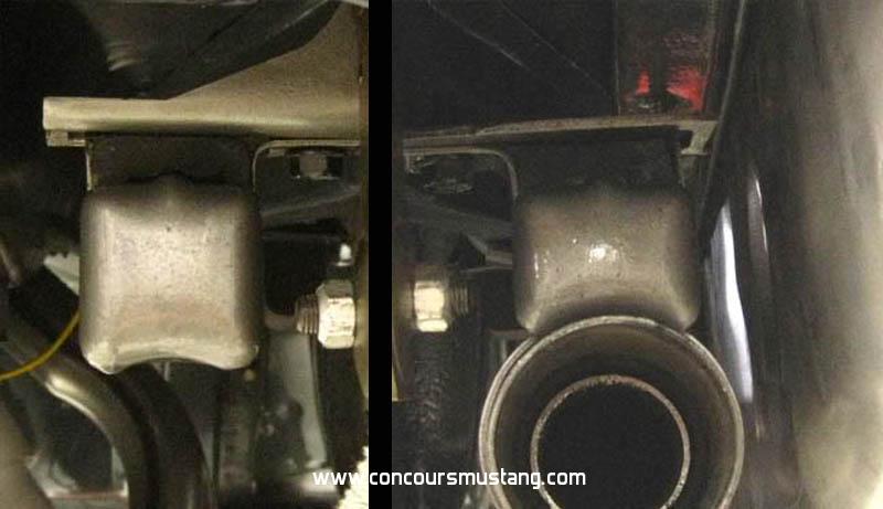

We were short one of the rear hangers (the large U shaped section) so we ordered up a pair of the current reproductions.  Though we used them to put the system in the car (holding parts in place) we did discover a difference between the originals and the importance of getting the right reproduction part I though I should share.
If you notice in the pictures I posted a comparison picture (original on the right - repo on the left) below. The height of the formed section facing the rear is at least 3/8" taller or more on the one version of the  reproduction.
So if things at the back are not lining up like they should - you might want to check and confirm that you have the right (original style) parts ;)

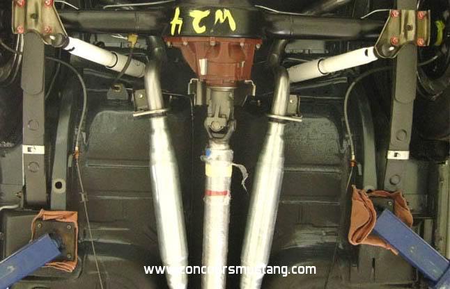

Very nice pictures. What goes on the end of the pipes for tail pipes?
MCA #33800, Gold Card 3rd Gen
BAMA Member
At the back end (pic #5 above) is an adapter that connects to the large rear manifold that guides exhaust gases from that point to under the rear bumper in the center

I see the last two pics are my concern, where the bracket bolts to the frame and/or the trunk floor by the rear shackle, it just does not line up to the collector, i removed the rear bumper, rear valance, gas tank, and it just makes no sense  on the mount of the bracket that the hanger hooks on to! do you happen to have a pic before the hanger is placed on the bracket?
Re: 69 GT350 Sportroof restoration thread - Exhaust (lots of pics - as usual)
« Reply #13 on: February 26, 2023, 11:13:58 PM »
I see the last two pics are my concern, where the bracket bolts to the frame and/or the trunk floor by the rear shackle,........
The bracket attaches to the rear frame rail on both sides with carriage bolts on the bracket side and shouldered nuts on the other
.... it just does not line up to the collector, i removed the rear bumper, rear valance, gas tank, and it just makes no sense  on the mount of the bracket that the hanger hooks on to! do you happen to have a pic before the hanger is placed on the bracket?

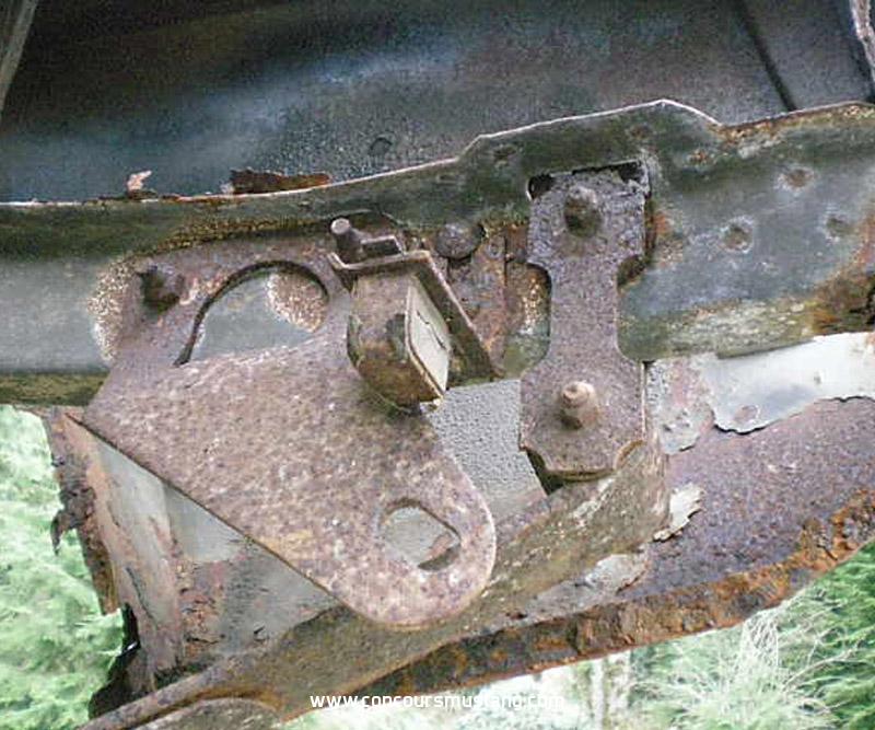

Doesn't look like many found the location half assembled was worthy of taking a picture of. Found two that only give a peek at the bracket (and really odd angles) but the lower shows the bracket and other things around the area Did find a number of cars that were built with replacement exhaust systems that just left the bracket and parts off. Unsure how much those systems rattled  ::) Hope this helps
