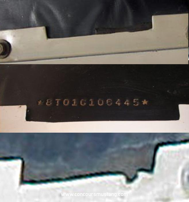

If someone else posted this and I missed it in all the responses please forgive my missing it
68 is an odd year in relationship to the drivers side VIN and if it was intended to be visible or not. This has come up many times but gets lost for some reason. It depended on the assembly plant and their practices/instructions to those workers at that plant
One related thread but for San Jose
https://www.concoursmustang.com/forum/index.php?topic=18835.msg119813#msg119813
Bottom line - Shown in the same order as in the picture. Tried to find all the same colored cars :)
Dearborn - Typically hidden
NJ - Typically visible
San Jose - Typically  hidden
