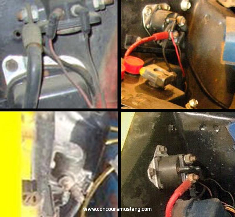

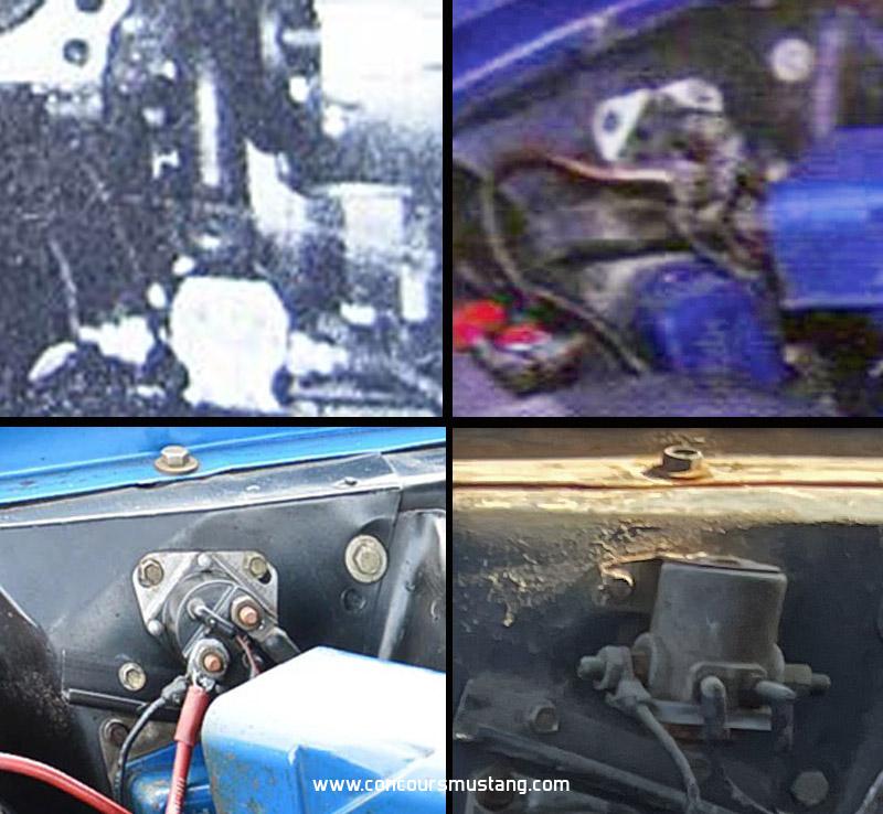

The two versions we see being used appear to be just different suppliers used by Ford during the later 60's. Seems that the company that made the flat style provided less that the more typical in 69 at all plants.
Not allot of period pictures of late 69 production but here is one of a very very early car and the rest are from unrestored example from about May through the end of production. Let you decide
Guess it would ne nice if I could find the time and graph 69 Dearborn cars (all engine types) and see if there is a pattern.
