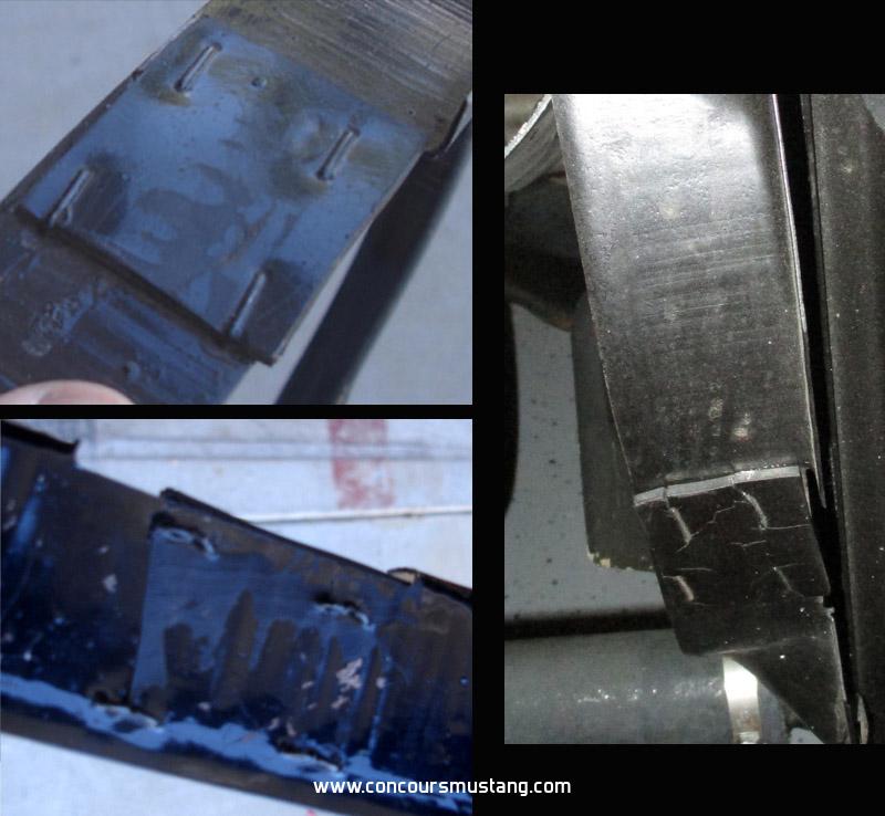

May 65 - Yes that would be how the shrouds arrived at the car assembly plants from the provider. There are some possibilities (looks like pretty certain) that some later 66's didn't have the feature.  In adding the pad and staples take notice that the shroud was painted after these were installed so the final look is black paint over the rubber pad as well as the staples as shown
Below - from another thread on the subject
