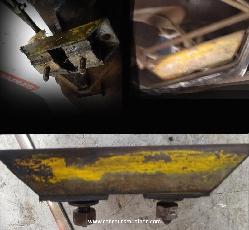

My 1967 GT 350, 4-speed, #1376 had a yellow marking on the transmission insulator.

Thanks and with that we know that the car was finished at Milpitas on Feb 28th - after the change.
My findings are the same as Tom posted and a few examples below so you can get a general idea of what tone and tint of yellow was used and coverage. As you can make out it appears that a large brush with a single pass was the method of application

Thank you Jeff!
would my engine insulator mounts also get the same yellow marking?
