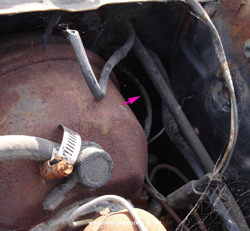

Richard is this the loom your looking for?
From 7R1156xx
From 7R1156xx
Yes, that looks like what has been described.

Thanks for confirming what I'll be looking for. Don't have the real build date of the car in the post above :(

The area marked in yellow contain male bullets, which are receivers of power.  It appears that your picture does not contain the typical pigtail pickups of turn signals (3 pin) normally found at the turn signal connector areas at the front of the car.  I think what is missing is that harness that picks up those signals from the pigtails, routes them to the firewall area, where the male bullets plug into and passes it on to the 2 pin molded connector that mates with the hood harness.
My suspicion is that this early version incorporates 2 separate harnesses for hood turn signals outside of the hood harness itself, and that the later versions use a single, integrated version using the 3 pin turn signal pigtails and the one dual pin plug for the hood harness.

Haven't had time to look yet but with the separate loom do it pass through a separate hole in the firewall or share with one of the other looms?  Looking for another way to find examples of the single loom on those cars if there was an "extra" hole.
Tough dark area of the engine compartment that does not stand out well unless your focusing the picture on just that small dark area  ::)

Jeff : The Owner of the Shop where my friend purchased this "auxiliary" harness/ loom, told him that itcame from an early October GT, and went through the same grommet as the Headlight Harness. Hearsay I know, but that's what he told him.

Thanks. As usual or "job" is to help determine if dates of changes and other things match up with what was done in real life and if it varied (the date) from plant to plant. Just thought if it was an additional hole that would be another way to identify those cars with that version even if the wire was no longer there.

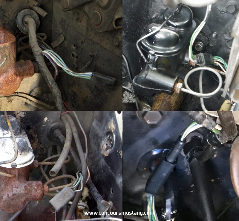

Just an example of the intergrated hood lamp wiring in the the main wire loom that was used later in the production year.
Must mention that one of these four is from a pretty early car. but the original early version may have been swapped out during a repair for some reason early in the cars life. Don't know for certain
Guess we can also look fro the earlist cars with the later version as well as the latest cars with the early version by plant
