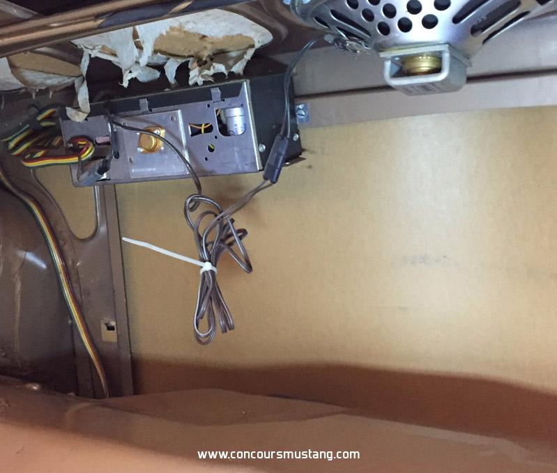

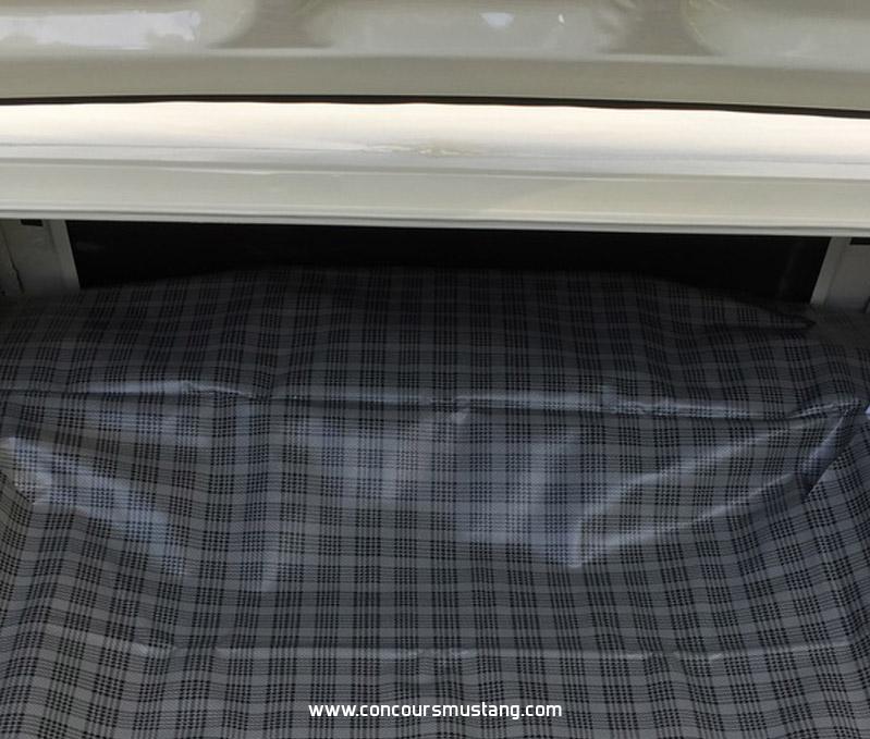

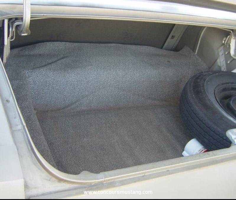

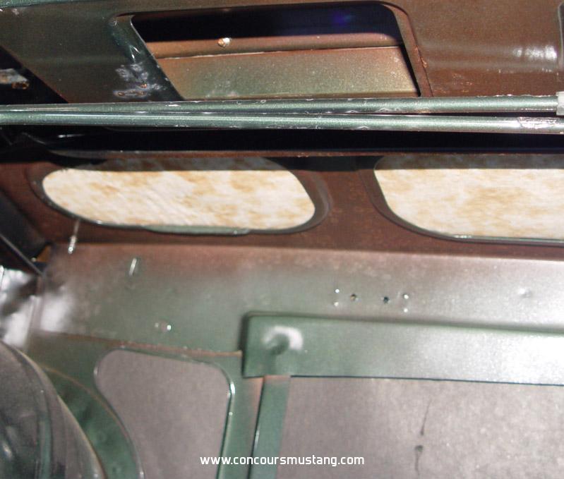

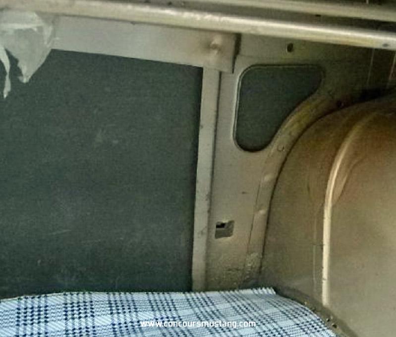

To that end I've posted some examples of what appear to be original panels below for your and others consideration. Appears that its the same or similar to the product we see at the other two plants. Multiple layer (not corrugated) cardboard product of some type dyed all the way through typically in black. Though there was one odd ball I found that appeared not to have been dyed for some reason. Just posting it so that we find others of the same style from the same plant and time period we can start following that. At this time would suggest going that route
Hope these help
5F07U1132xx
5F07K264xxx Not much of a view but it is black. Also a real poorly made repo trunk mat
5F07A270xxx
5F07K281xxx Odd un-dyed example
5F07C628xxx
Not sure if anyone else has a picture or two to contribute also
