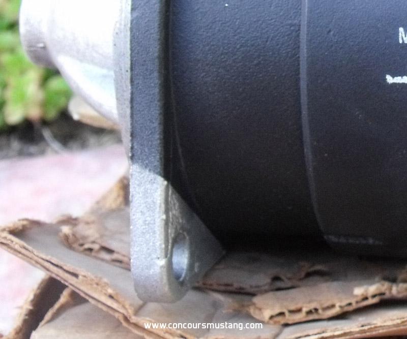

Yes in some factory pictures there are starters with a sharp or taped masked ground end of the starter. Similar but not exactly the same as your picture
One example (looks like a similar or same pattern) is visible in the engine drop picture in the 68 San Jose pictures in the Assembly Line section of the site - San Jose - 68 San Jose - Engine Installation - 10307-12 First in Series
May be the supplier/factory since I've got pictures of service replacements with a taped ear or two while others like some found on original cars without the tape and just a misting of paint overall
C6 marked service example with the taped ear

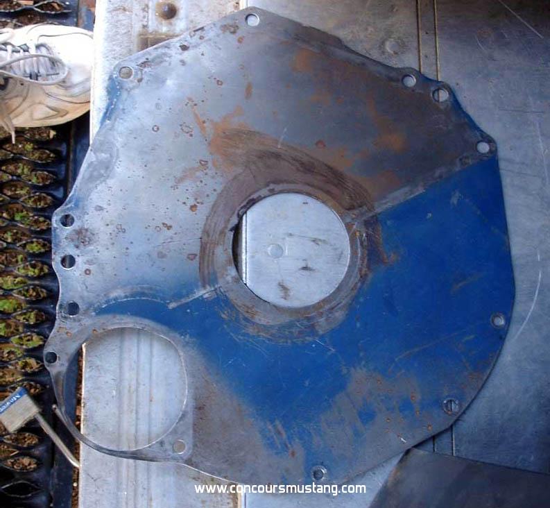

Other odd things in that photo too like engine block plate lack of paint and hardware holding the plate to the bell.
