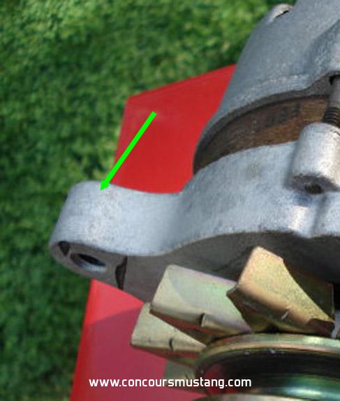

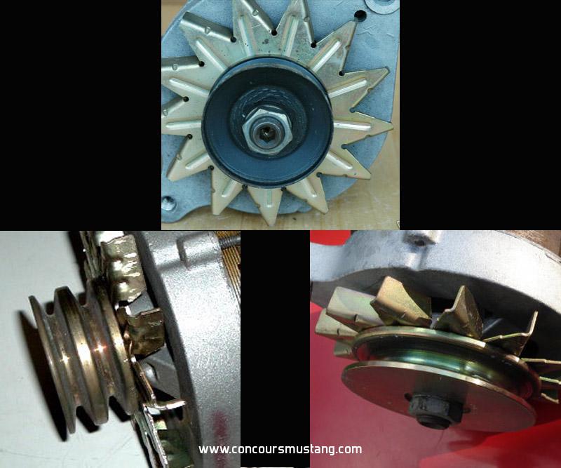

1- Pulley type size and number (dual or single)
2- Shape of the lug (for lack of a better term) where the adjusting arm attaches to the front part of the case.
3- Shape of the rear of the main housing/case and if AUTOLITE is cast into the back side around the center of the shaft area. Change from earlier round detail to teardrop took place somewhere around the middle of 67 production
