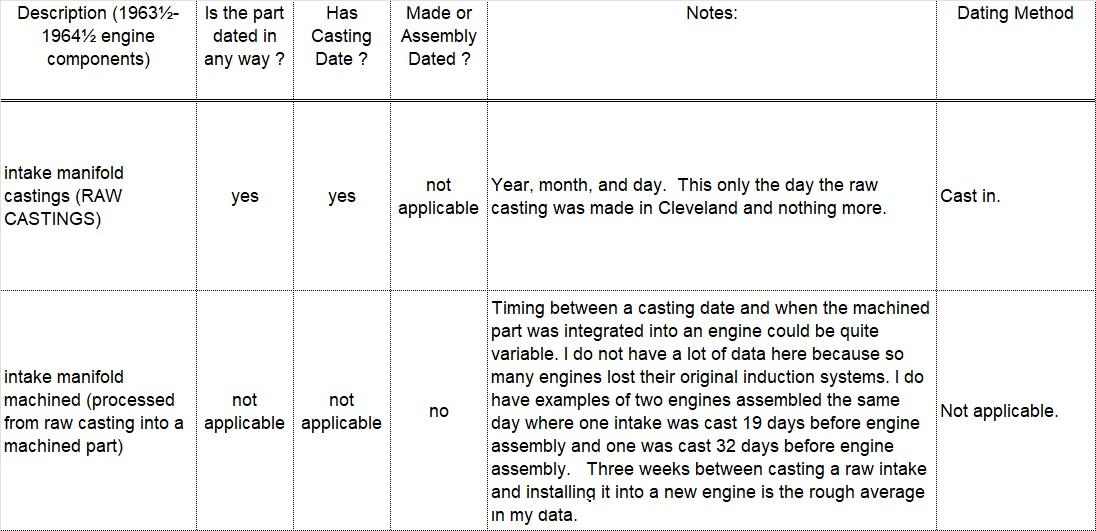

Andy,
Dates of engine components is not very simple. Part and assemblies were made in multiple factories and combined into engines at the Cleveland engine plant. The Cleveland plant cast the large iron pieces and built the engines.  Vehicle assembly plants were a completely different subject. I do not have any file short enough to cut and paste into tiny forum blocks but I made a cut and paste for 1963-64 intakes and 289 High Performance engines for you.
My 1963-64 table might not answer every question you might come up with about dated engine components but it might arm you with enough information to ask very specific questions. If you want a copy I will need you to get your email address to me.
Dan

« Reply #8 on: February 09, 2023, 06:18:11 PM »
Very helpful Dan, and makes sense. I'll PM my email to you. Much appreciated.
Email sent, if that file type doesn't work, I will try another.
