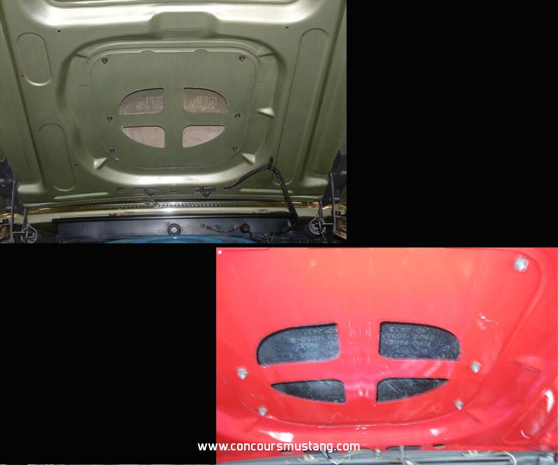

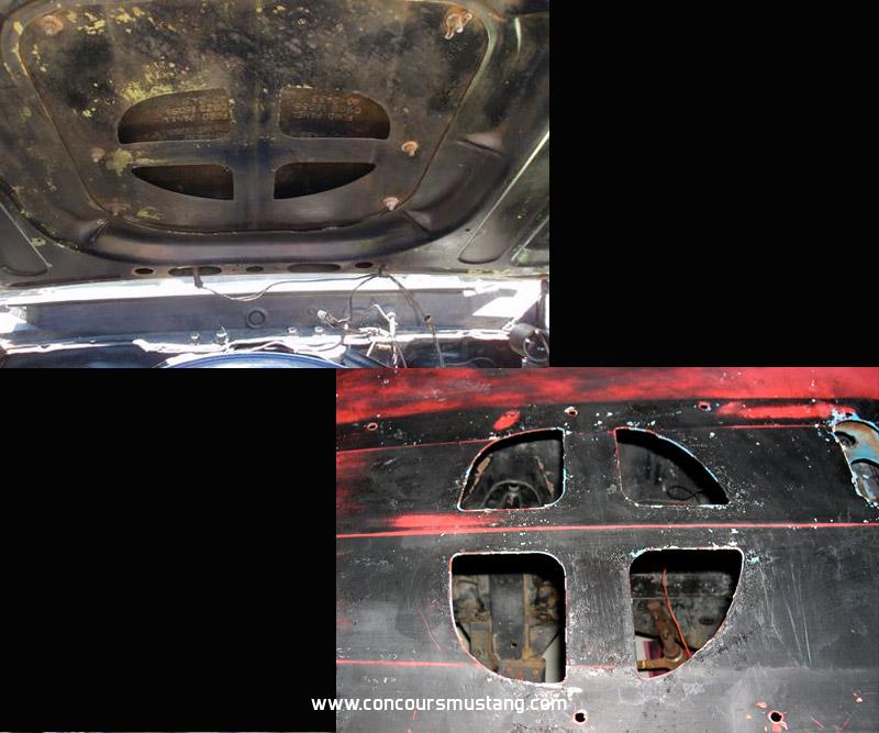

Thanks JohnB!!   Great info! Here's some pics that confirm it's an early hood and original. 😀👍
Thanks for posting additional pictures. Don't be mislead by Marcus' labeling of the versions as being related to the order they were installed on Mustangs. Especially at San Jose. Think of them more as just identifiers at this point for his article.
Looking at what I have it appears that this version with the "pie shaped" cutouts without the cutouts in the  oval stampings on either or both sides was originally installed on cars San Jose planned on building in the month of November 1968 (projected build date from the door tags) and assigned VINs between approx 9R120xxx and 9R126xxx. This would nicely IMHO match with 10 17 W2 stamping date on the hood you posted. Mind sharing the cars VIN or all but the last two digits here or in a PM so I can add it to the list and chart it with the others?
A few examples from San Jose cars. Will start threads for both other plans then link to running changes main threads as is our practice here.
As a side note all the examples in the pictures are M code cars but the cutouts have been found on Q codes also at other plants
