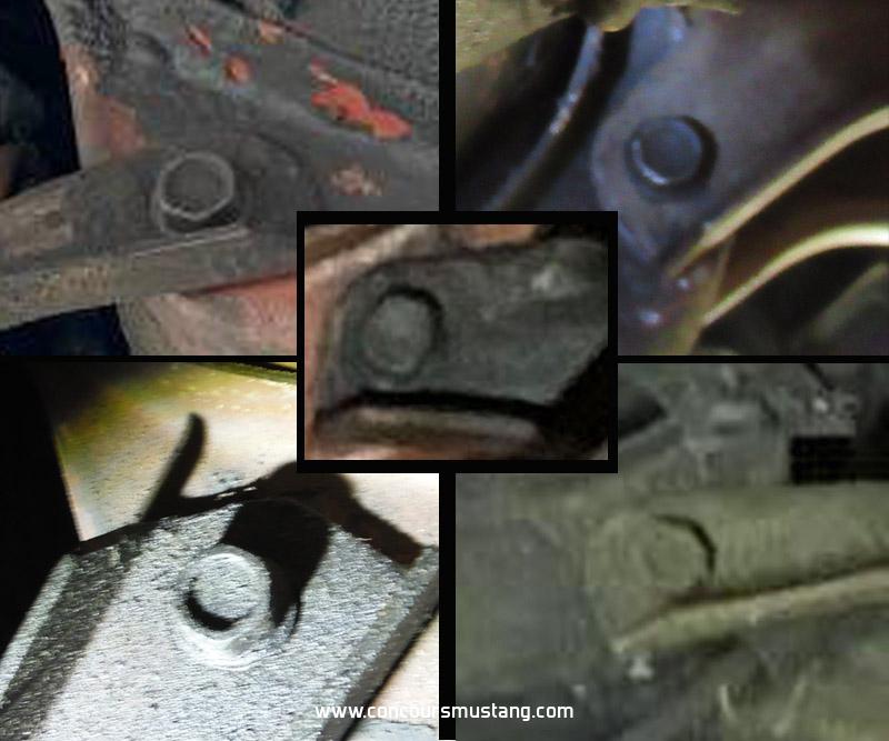

Re: 1967 GT500 Transmission insulator
« Reply #3 on: March 03, 2023, 08:00:48 PM »
Looked through the collection focusing on unrestored examples and ones that showed no sign of having the transmission removed before the picture was taken.
Found that they, the long bolts used to secure the transmission mount to the body bracket were installed from the rear of the car with the nut on the forward end as shown in the five pictures I choose of the ones I collected. Hope this helps Shelby and San Jose Mustang owners
