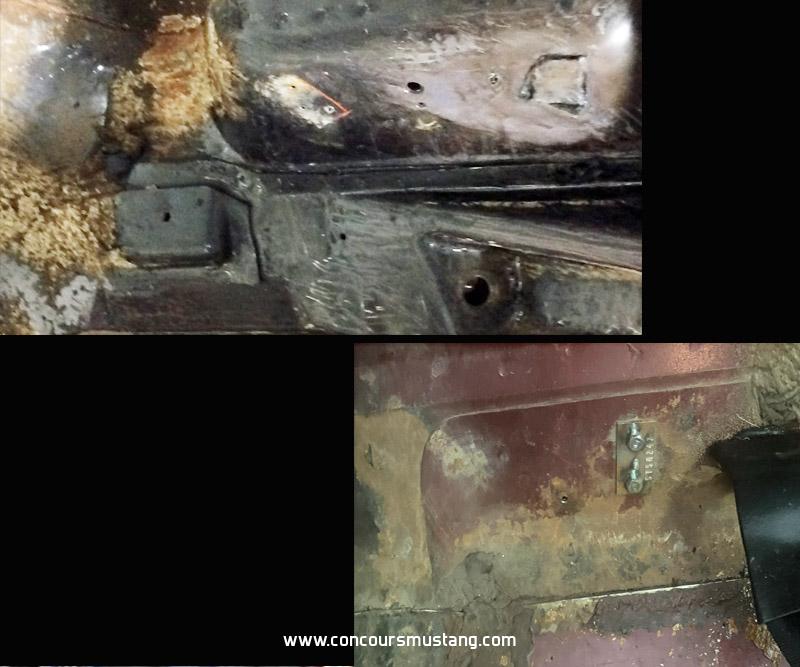

Offline andric2
  • Posts: 9
  • 701-702-2123
Re: Dual exhaust non-GT
« Reply #18 on: March 04, 2023, 08:58:31 PM »
Jeff,     There are two hole in front of tie down bracket in vertical position. Picture attached. The bracket you referred to was originally damaged. The tab was broken off. We welded anew bracket in the same location as the old one. Picture attached. Not sure where to look for floor pan date code. Looked in general area and couldn?t see anything. Rocker panel had what I believe was date codes. Couldn?t read them though. Picture also attached.

  • Posts: 7750
« Reply #19 on: March 04, 2023, 09:01:03 PM »
The reinforcement plates under the rear seat were originally spot welded in place.  Those spot welds are normally seen on the bottom of the car, around the perimeter of the plate.
Offline andric2
  • Posts: 9
  • 701-702-2123
« Reply #20 on: March 04, 2023, 09:26:16 PM »
Charles,      I took a couple of pictures in the area you mentioned. There appears to be spot welds.

  • Posts: 7750
« Reply #21 on: March 04, 2023, 09:58:52 PM »
2 possibilities:
-Assembly line error
-Repair made to the car with an original rear section from a factory dual exhaust car
Going to have to be some more sleuthing here to dig to the bottom of this.  As mentioned, probably going to take a full account of any visible sheet metal date stampings.
