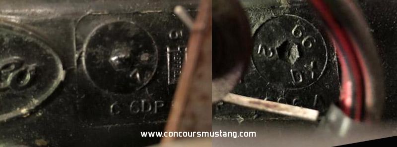

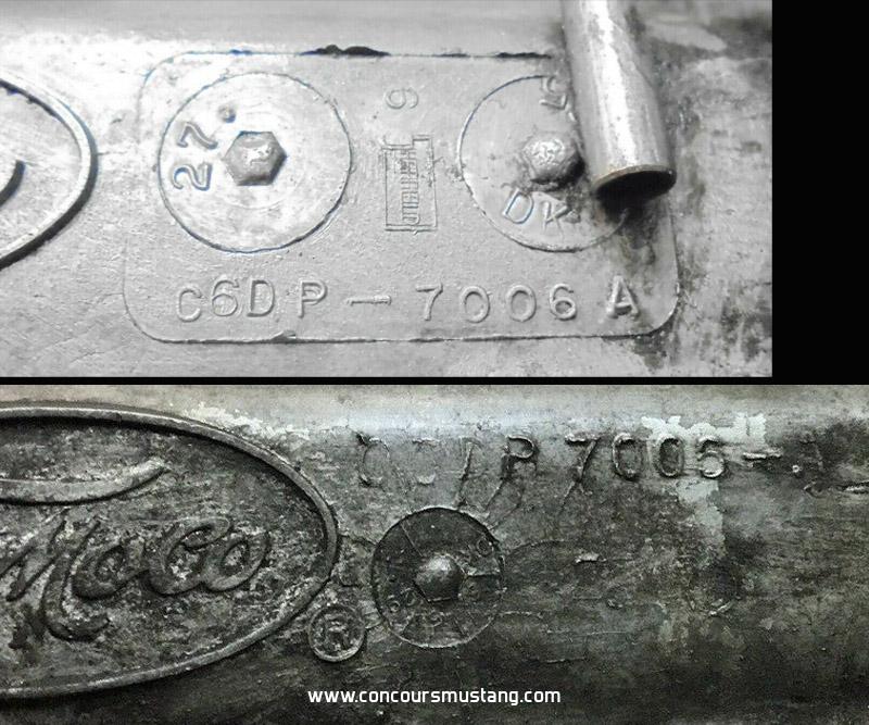

Now about the single date wheel on the transmission case and the casting number  over the "wheel" verses two wheels and the casting number smaller and under the wheels I can't been certain.  Have seen them both ways but the vast majority I've seen and have pictures of is the two wheel with the smaller casting number below and a "box' or line around all three castings as shown below. The two wheel with the casting number was used through the C8 period at least. Have examples of C4, C5, C6 & C8
An original from a examples likely built mid March at San Jose. Had to piece two pictures together to show both wheels

As for the date wheel, yes I saw that thread about the wheels and was very interested to read about dating the casting by the number of dots inside the wheel (which I would never had guessed in a million years)... ;D
So I suppose I'll just be content that my car is the fourth month 66, and there are four dots with a big 66 nearby... :)
