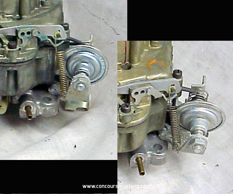

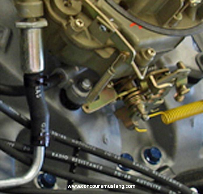

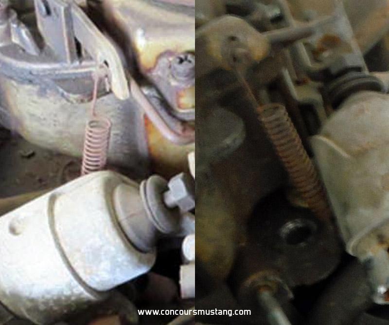

Think you may have to get one from a donor carb. May be able to widen your search to include carbs from other years to improve your chances
Some examples
68 NOS examples
69 restored example
70 original examples

Update on my findings, with a known part number I searched the catalog for a carburetor that used the same spring, 429 / 460  4V carburetor matched, and gave me the dimensions of the spring that was not given under the 351W part listing. I noticed a FoMoCo carburetor kit that contained a spring that appeared to be correct - measures to specifications. So an NOS spring for my 1969 Shelby GT350 4 speed Autolite 4300  4V carburetor.
