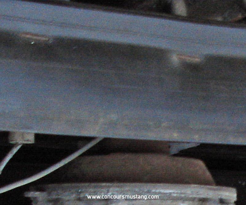

At least most were round stock based on only seeing round over the years on survivor type cars. I have not seen the square stock like you described so if it was used it must be in the minority.

Agree with others that I've not seen anything other than industrial round style staples used for this purpose no matter what year or plant though it is really advisable to include when and where your car your asking details about is included in the question. If not your going to get asked for it just about every time :)  Its suggested, especially if your only doing one car to include it in your signature so that you don't have to type it every time.
